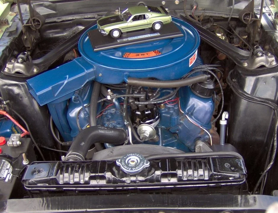

I just purchased an ol 69, it needs work. The body is decent. The engine? I have no real idea of what it is.. neither did the previous owner.
I have done some smaller work on an older 88 jeep cherokee, a 70 chevy truck and a 47 willeys jeep. No professional at all. I just google and read forums a lot.
So my questions I guess are.
What engine is in it?
___
What parts should I look for to get some umph.. in the engine without breaking the bank and something I can put on it.. Im aware it needs a 4 barrel carb.
What about getting power steering and brakes back? Any ideas?
No headlights? Other lights all work, the PO said that they worked when he parked it a month ago? Thoughts?
I will have more to come and thanks!
Here are a couple more pics of the engine. Thanks for the help so far. I cant see any numbers on this block and i cant really get under it easily where it sits now. Any knowledge would be great. Thanks!

Sounds like it is time to crawl underneath and get the casting number and date code off the block!
2+2GT
Apr 25, 2009
3,333
10
79
Southeastern Pennsylvania
Sep 28, 2010
  • Sep 28, 2010
The photo is not very good on detail, but the 351 Cleveland valve cover stands out pretty well. The EGR implies it's a 73 or later engine.
Don't drive it until you install cowl braces, or better, an export brace.
The 351C 2V can be upgraded with a conversion intake manifold, and of course there are many cams for this engine.

Thanks for the reply there. I will get the numbers i can off the block, the guy I got it from said the engine was off a 73 or 74 ford truck.

Ok I added a couple of pics hope these help. Thanks everyone!

Your engine is a 351M or 400. That flat just to the right of the distributor is almost level with the flat under the distributor on a 351C engine. 351Ms are slightly taller than the C version much like a 351W is to a 302. 351Ms & 400s were truck and big car engines and don't have much for aftermarket parts, not very desirable.
