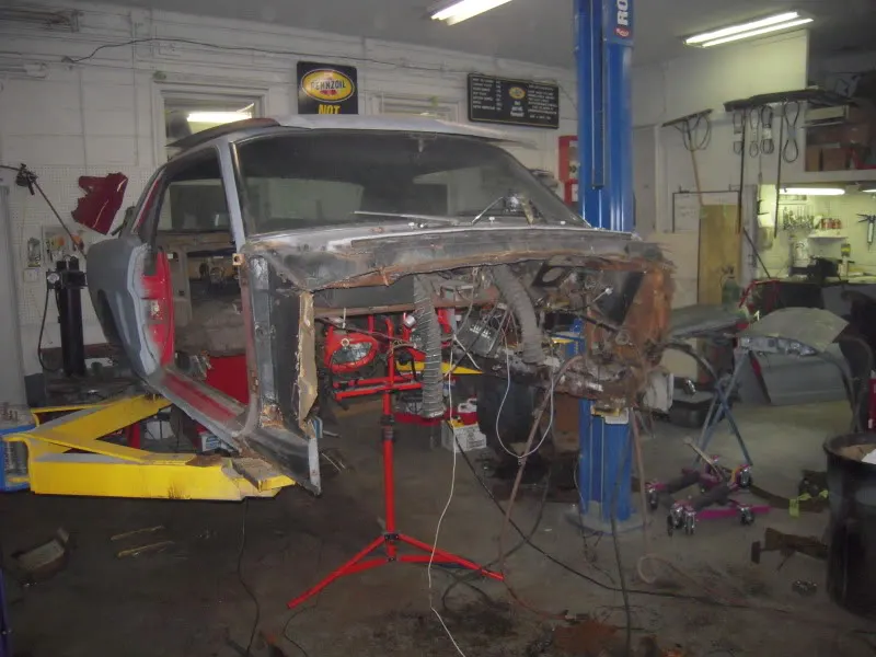

Well epoxy primer is the best possible thing to use. I do restoration work for a living (currently doing a full resto on a 66 coupe myself at the shop). I don't really like POR15, it doesn't look nice and even tho they say it seals rust, I'm still not convinced it works. Post up some pics of her!!!! Here's how the 66 im doing looks right now haha
