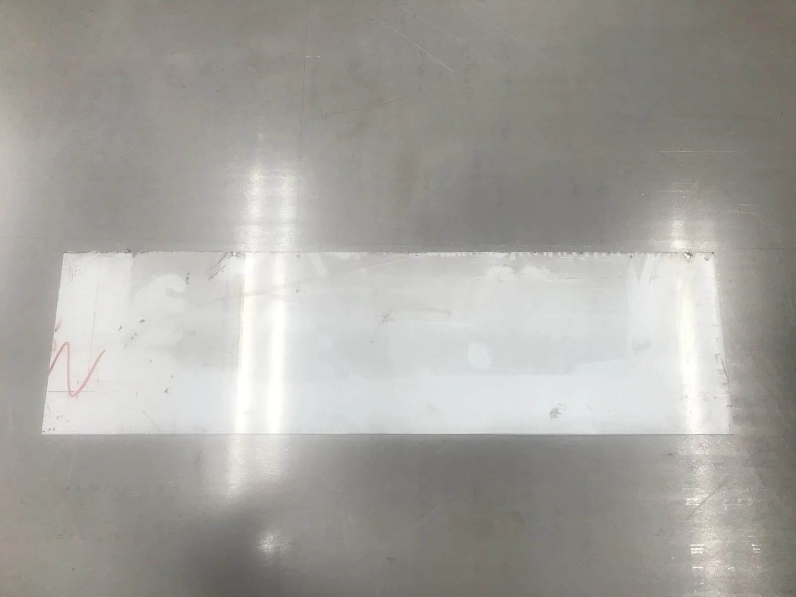

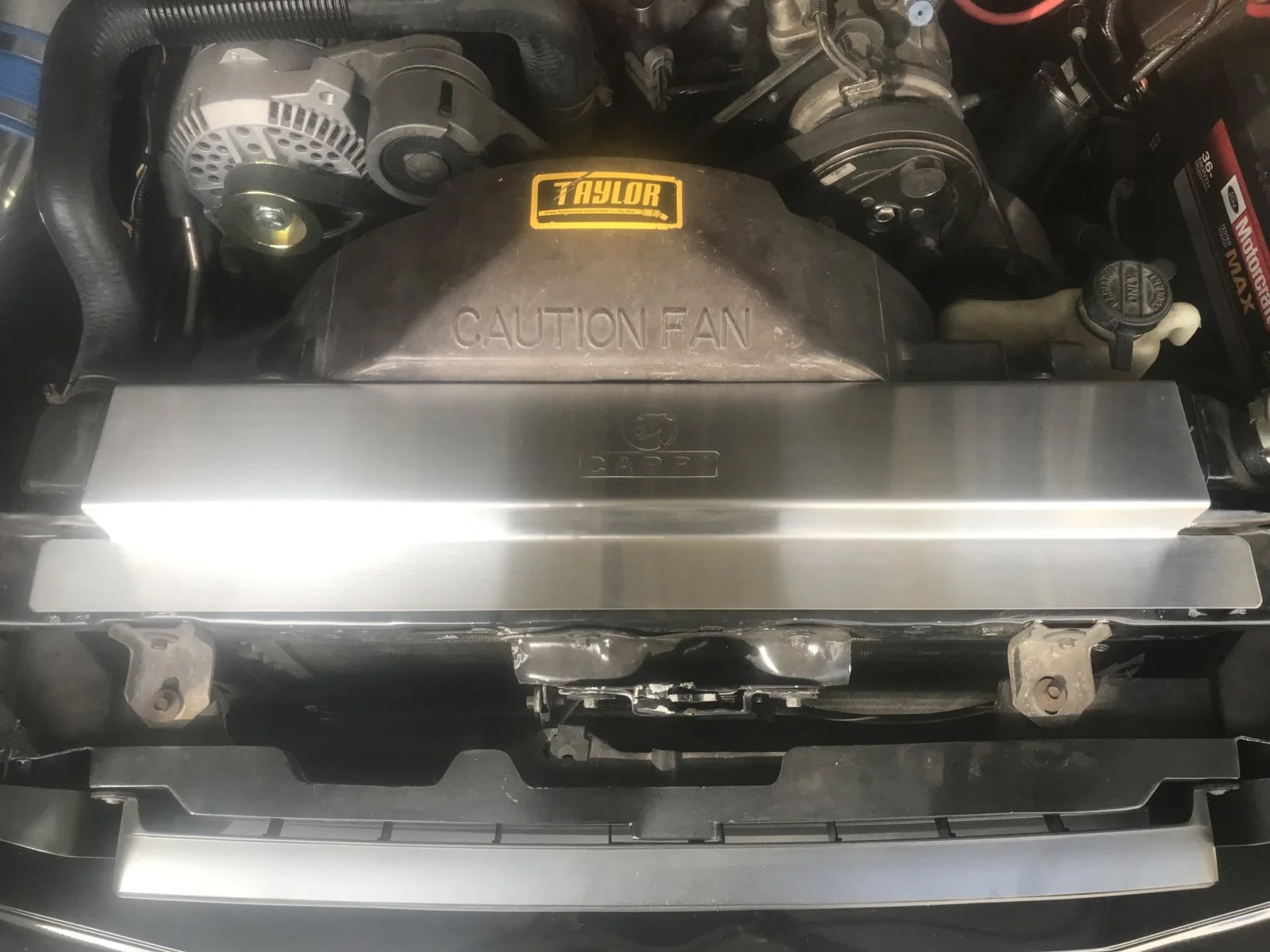

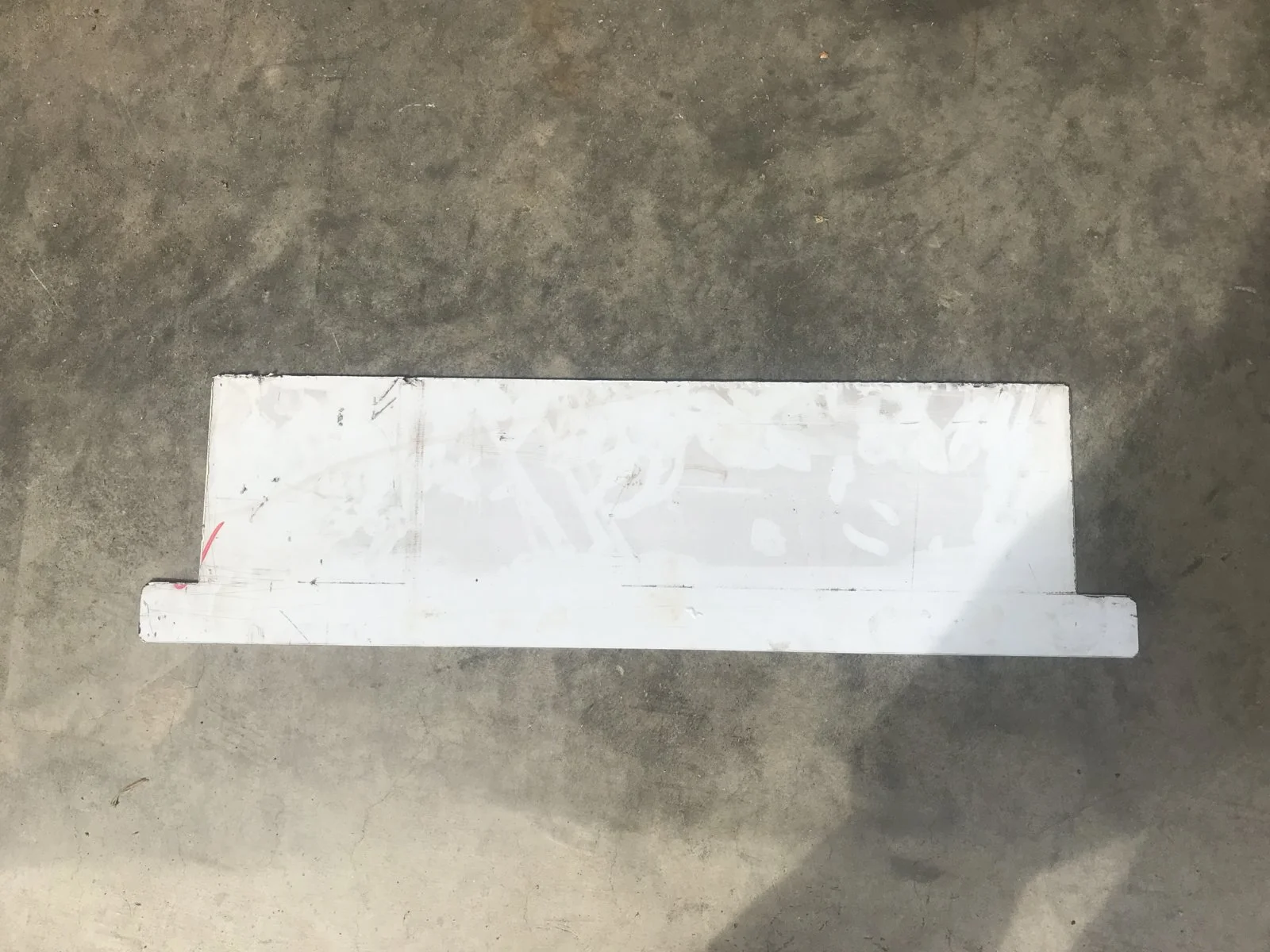

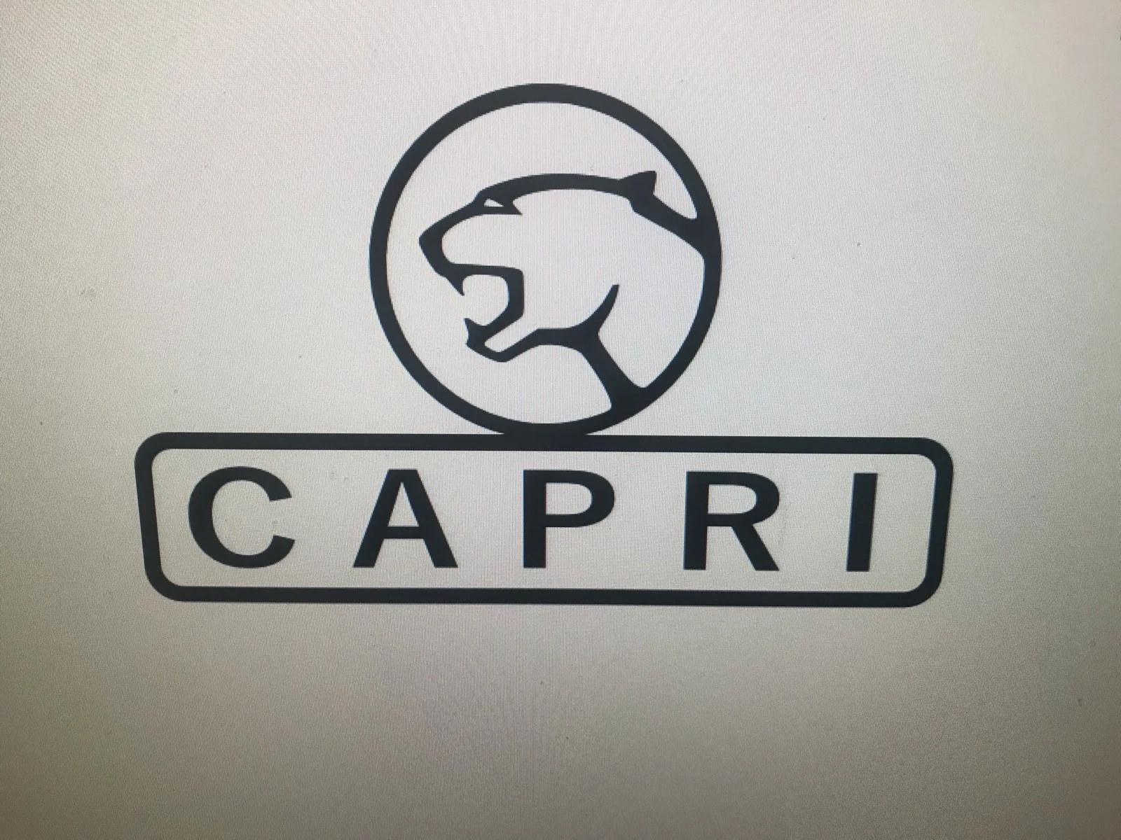

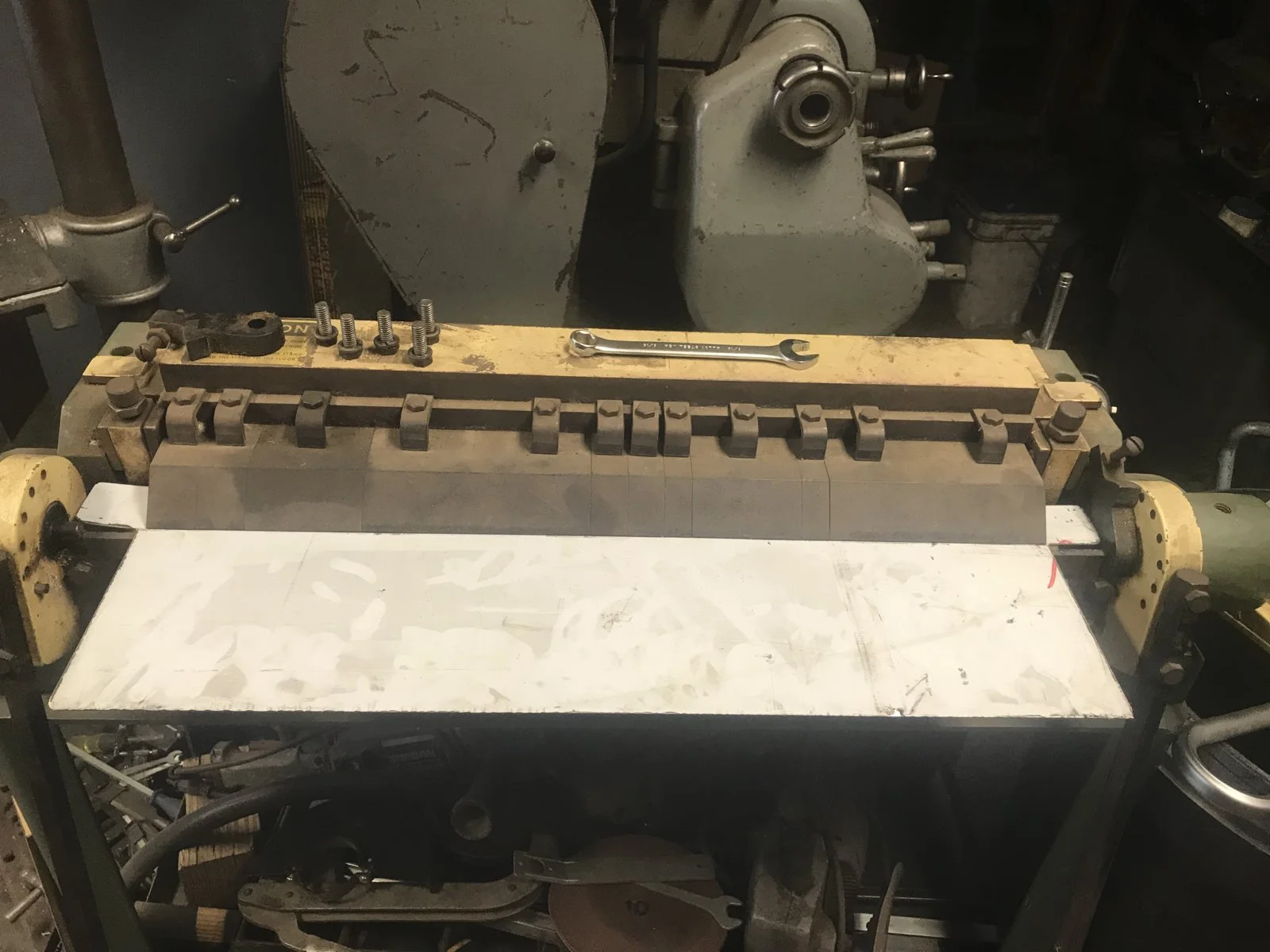

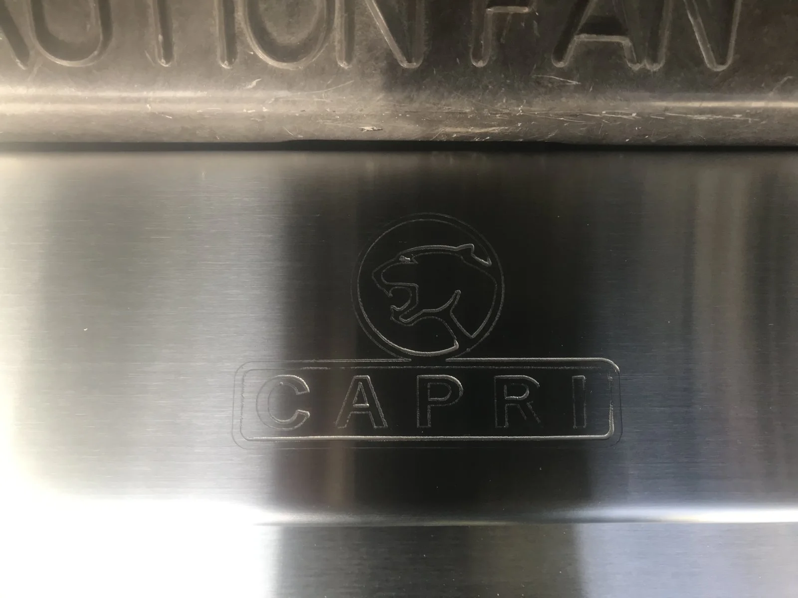

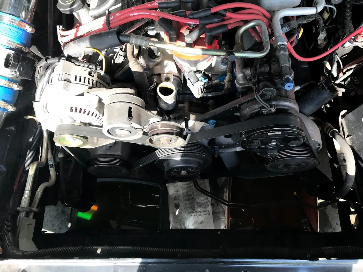

So as we all know even though our car might be done, they are really never finished. There’s always a new part we want, weather it’s to make us go faster or look better. Well hopefully this one will dress up my engine bay a little bit. Here’s a couple of pics of my homemade radiator cover.

CNC dremel wow almost unbelievable but really cool.

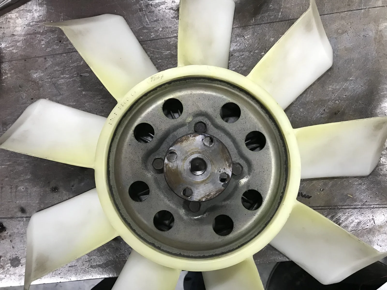

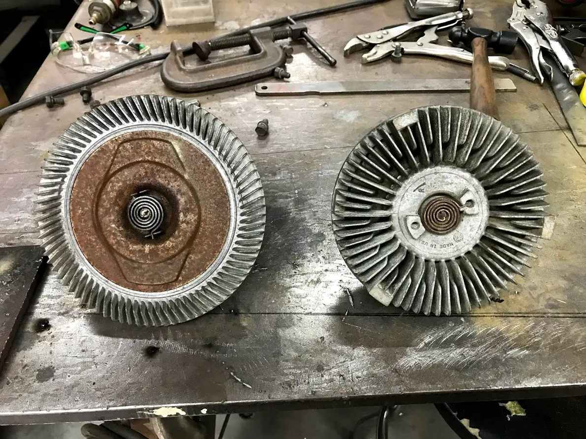

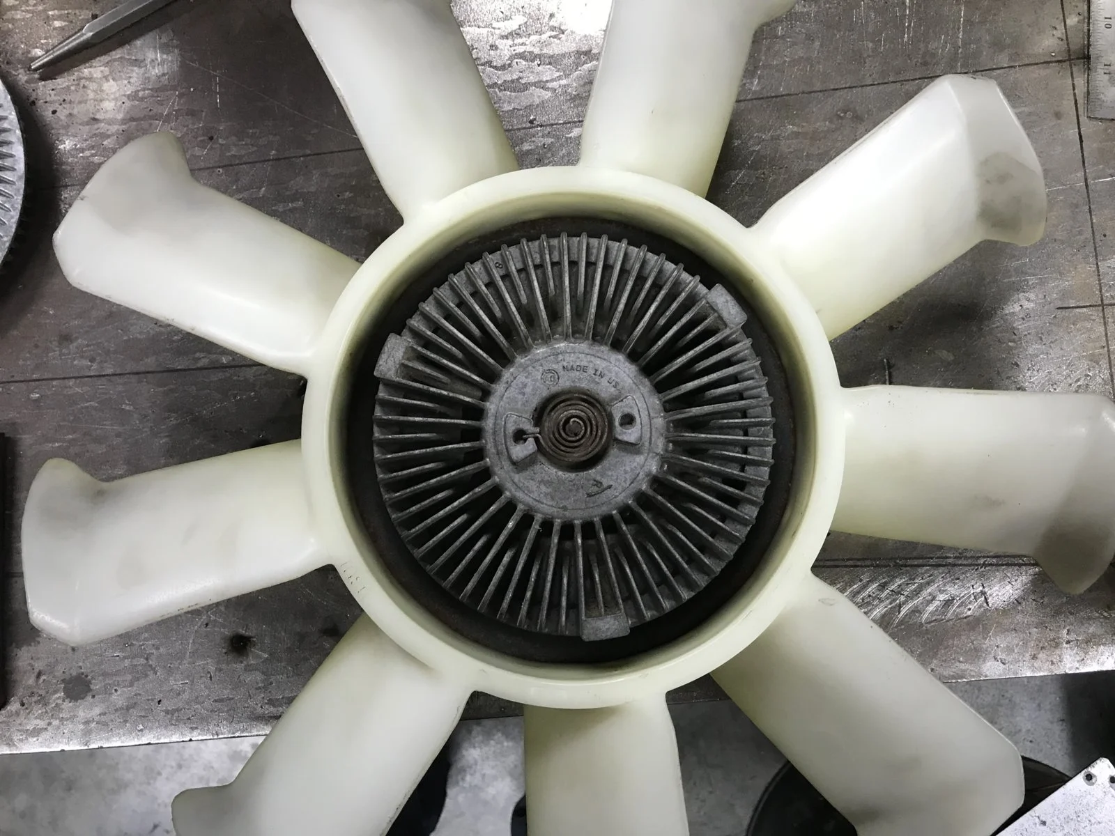

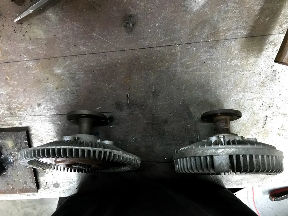

I started installing the sve aluminum radiator today and i have a few questions. Not on the radiator, that pretty basic, but on the cooling system itself. When I took a tuning class with Steve we noticed the car running pretty hot. It reach 220* while it sat and idled for a decent amount of time, not sure but probably close to an hour. Steve had thought that the fan clutch could be bad. That seems reasonable because I believe it's original to the car. I have a fan clutch from the 351w, mentioned above, and noticed that it is much harder to turn by hand. The clutch from the car spins very freely.
Looking ahead to the turbo install I was thinking of going with the contour electric fans. Whats your opinion on that? Would you wire them to be controlled by the microsquirt or use a separate fan controller?

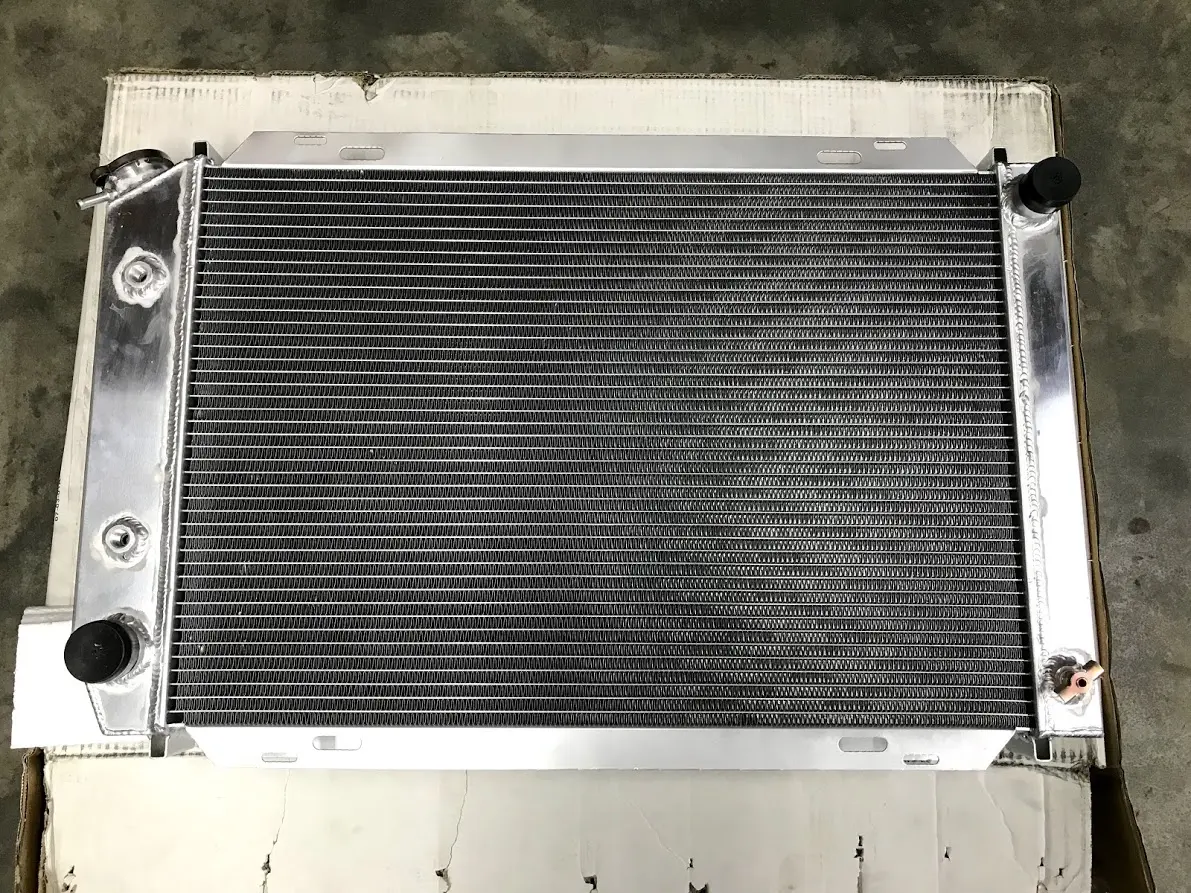

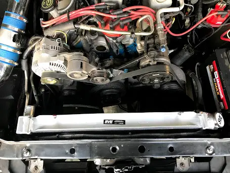

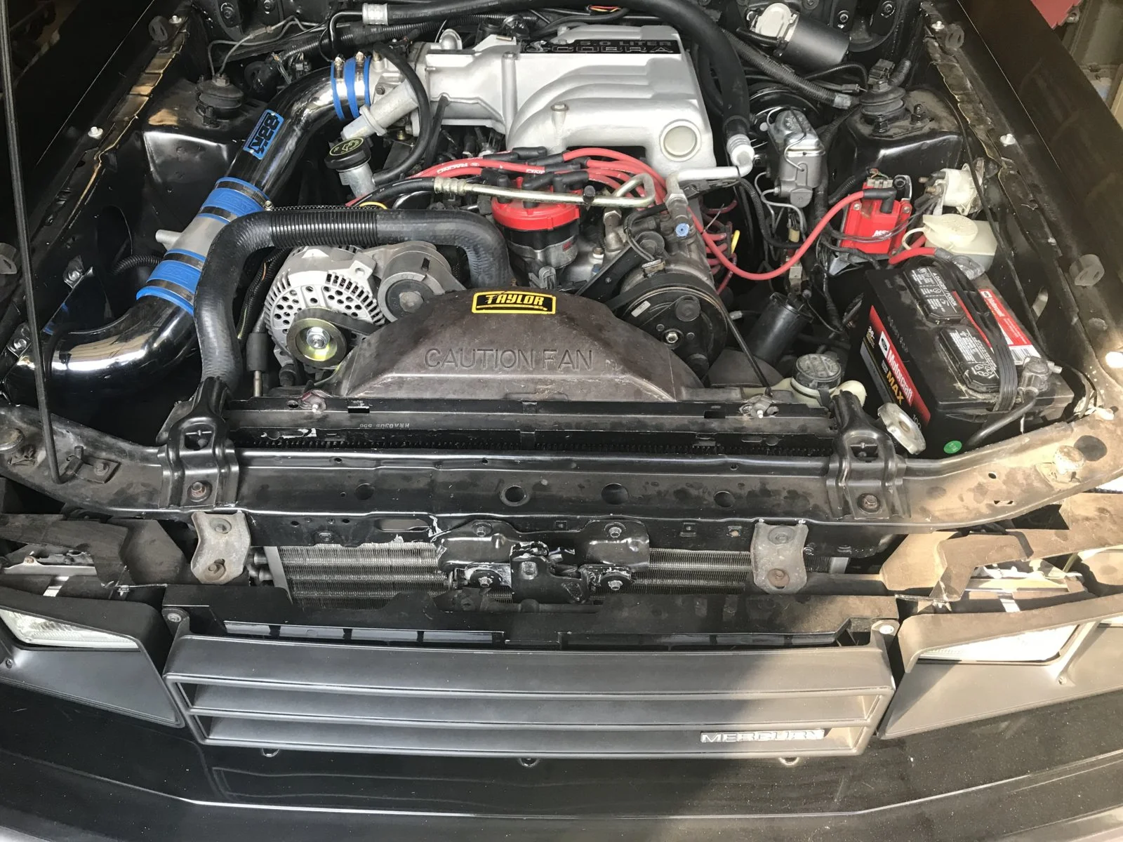

Here's a few pics of the new radiator, I know it's not that exciting but it's progress none the less.
Out with the old
In with the new
Fan clutch from the car is on the left and clutch from the van is on the right
