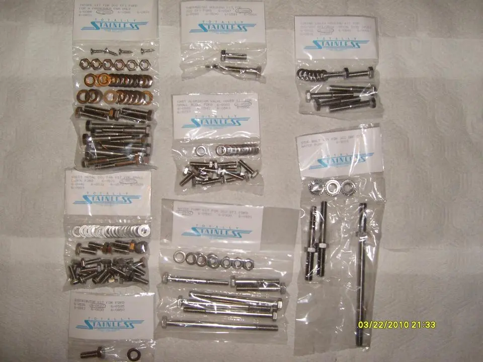

Here are the bolts that Totally Stainless has:
http://www.veryuseful.com/mustang/tech/tmp/TotallyStainlessWaterPumpBolts.jpg
As I remember, I got the "Engine Kit 5.0L EFI SBF" (6-0897) (~$45), and the the "Stud Bolt Kit for 302 SBF EFI Water Pump" (6-9029)(~$30). Plus, ~$10 for shipping and handling.
Check and verify those numbers and prices before ordering!
Also, it took ~5 weeks before I received them. So, if you need something NOW, I'd suggest asking before you order!
