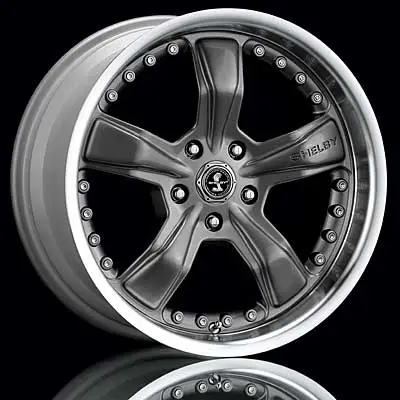

Will 18" Shelby Razor 5's fit ok with 2001 cobra? Someone said these are for the 2005+ ??

Yes for the most part. Your stock center caps will fit.
