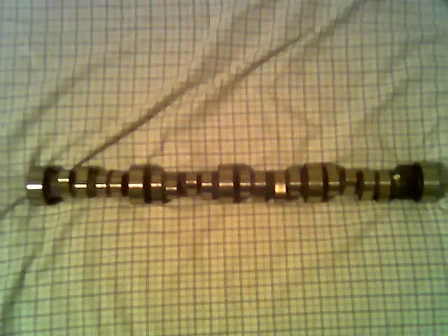

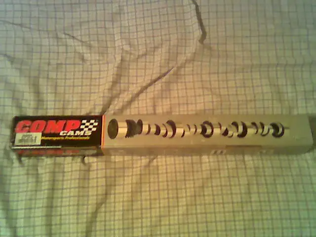

well i have been waiting for to since the guy said it shipped it thursday. I had the start work today at 7 but when the first 15 min break came around i headed to the post office!!!and this is what i found!!(pics taken with camera phone)
It is the comp cams Xtreme energy EFI XE274HR
[email protected]= 224/232
valve lift with 1.6 rockers= 555/565
Lode seperation angle= 112
A real big thanks to Mike(mikemustang289) For the great deal on the cam!!!:nice:

Make sure you get some nice relieves in the pistons... Anything over 230 @.050 with anything larger then a 1.90 intake valve usually needs to be flycut (stock pistons) :nice: I had an XE274H in my 83 (flat tappet, completely different grind) and it sounded siiiiiiick..... Hell... Photobucket now lets you host videos... Here's the old girl.. I miss her.... (after AFR's and the XE)
