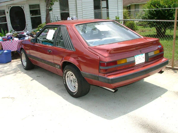

He mentioned that the mechanic that checked it out told him that he did not think the engine was the original. His mechanic told him that the engine looked like it came out of a 1992. I have no clue. If I took a picture, would anyone be able to tell?
$2700? Buy that up, it looks like it's in great shape, i'd offer $2500 and consider it a good deal.
It has the same headers as 87-93 cars, im not sure if 86 used real headers like that or manifolds.
I notice it has a pedal assembly from a 5spd, with the clutch pedal cut off, looks like it used to be a 5spd car. The wiring on the interior is kinda scary...
