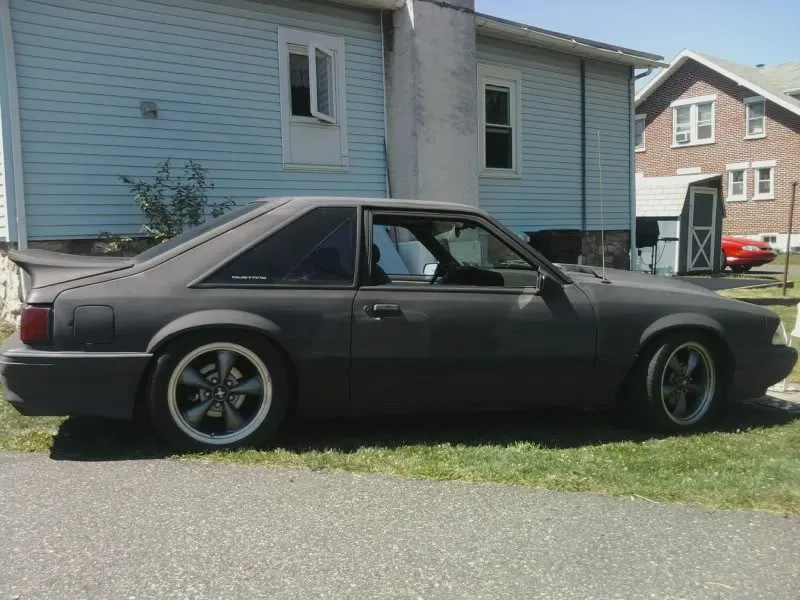

Hey Jon, how have you been man? Yeah that is a car that I'll never get rid of. I am actually TDY in Charleston SC right now. I took my brother's car and left Old Blue with him because it still has a warranty and I had to drive to Texas before I came here. Anyways I went home the other weekend and he had my car in primer! I don't exactly know what his plans are, but I think he is going to surprise me by painting it.
You should have seen it bro, that car looked killer in primer black! He is a Mustang guy so I know it's in good hands, and he says that it is running great. Anytime that I have ever let him borrow a car it has always come back running better and looking better than when I left it with him. How has your "new" fox been treating you? Hopefully it is running good for you. I'll talk to you later bro, take care!

Sorry, I realize this is off topic, but this is what old blue was looking like when I saw it the other week!
