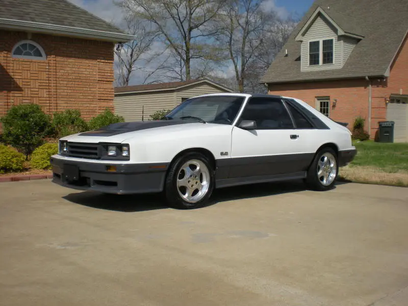

Shameless pic whoring opportunity intended to tempt you into getting it....lol.... :D
