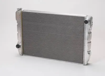

I believe this is the one he is looking at.
http://store.summitracing.com/partdetail.asp?autofilter=1&part=GRI-1-26272-X&N=115&autoview=sku
It is a universal one. 31 X 19.
$189.00

Summit has a direct fit griffin for $189, it's not int the online catalog, but it is in the catalog. Not sure the thickness, but it is for a mustang.
I was going to get it, instead i decided to spend $60 more and get the FMS aluminum with the plastic tanks.
Daggar said:
Dag, if you were speaking to me, here's the Part number:
GRI-7-479BC-FXX And FAX for the one with the trans cooler. For the Griffen of course.
And for the Ford Racing:M-8005-C 1979-93 Mustang
I typed the griffin number into the summit search box, and on that page it says universal, but in the catalog it says 79-93 mustang. It's in about all summit catalogs i have, which is alot. In most catalogs its in the seperate section right under the summit radiators.
