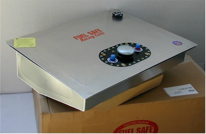

Also check out Delta Bay Mustang for the fuel cell. They have custom drop in tanks as well as pans and frames that use off-the-shelf fuel cells. Their prices were the lowest I found about a year ago.

Fostang said:
How do I go about ordering one like that?
Can it be a baffled/sumped tank also?
I would just give them a call. Johnny is the guy that knows about this particular tank. It's a 20 gal. unit so you could probably get it down to a 16 if you want. There is a sump if you notice on the pics on Eric's site and you could probably get baffles added as well. I think the most important thing on the tank is the lip that you drill to hold down and any modifications can be added.
