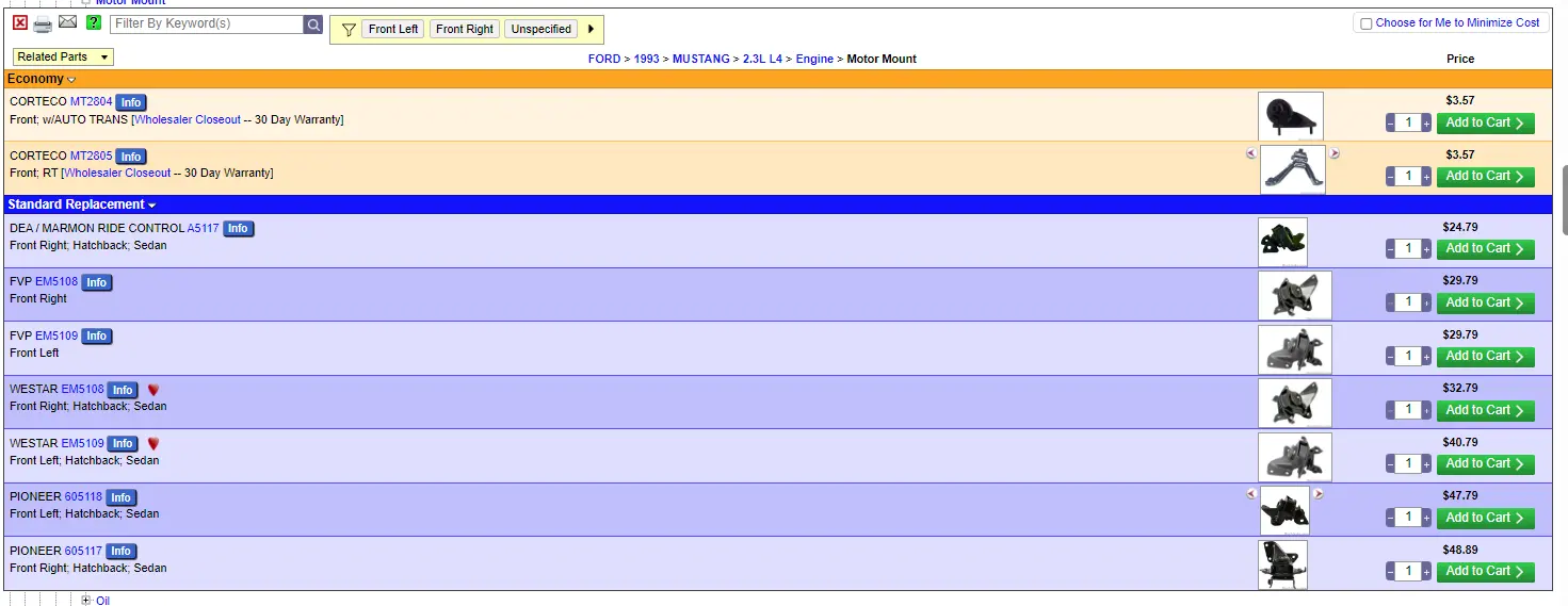

It was tough to find them back then. It appears impossible now. Does anyone know where I might be able to source a set, or is this just going to be something I have to deal with?
Rockauto has a few
The only motor mounts they make for the Fox Mustangs are the convertible style. They quite making the non-convertible a few years ago and I want to say the urethane motor mounts are designed like the convertible mounts. The convertible mounts would drop the motor about 3/4" lower in the engine bay vs the non-convertible mounts. I have also seen where some have commented they are stiffer but I cannot say one way or the other.
