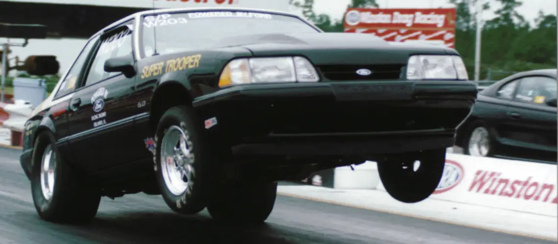

The recent 4.6 in the red car was a complete pull out out of an 02 GT. The 56 k mile engine coupled to the 5 speed 3650 cost me 1000.00. I left it intact...put it in the car, installed a MSD ignition, converted it over to carb, modified a cheap set of headers made it fit the stock k member,...there wasn't 3k in the whole swap...and it ran flawlessly.
The 460 that was in one of my previous Fairmonts was a 1000.00 short block after machine work. A flat tappet cam, a Weiand stealth intake, a 3310 Holley carb, ported stock heads, swap headers, a DIY build c4 , cheap 3000 stall converter, modified drive shaft and converted crossmember, and a drilled out super power shot plate..all DIY brought the total up to 6500.00.
And went 11.15 1/4 mile the first pass I brought it out. Eventually running high 9's before I broke it from too much nitrous, too much timing, too little octane.
You are the same guy...what ever you choose to do will be augmented by sweat equity. You live in Florida.. Shts cheap in Fla. Just as cheap as it is here. The banger in the Monster is a stupid expensive engine comparatively speaking...but it would've been obscene had I paid somebody else to do it. Pick what you want, farm out the machine work, and assemble it yourself.
Wallow in the reality that you never came close to spending anything that had 5 numbers in the total before the period.
