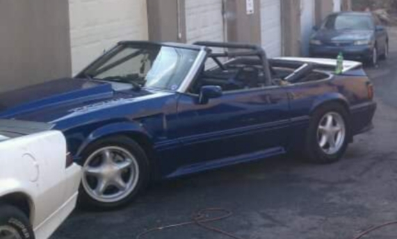

As many of you know, my luck has not been very good lately. After working with what was possibly the worlds worst machine shop, I am left with an engine that keeps eating itself. Before i jump off the deep end I need some direction for the car.
Some things you should know.
- Car is a convertible-
-Car has weld in SFC
-still 4 lug
-have the MM STB
-I want to install a 4 or 6 point roll bar with low slung door bars
- has a solid T5 in it
- The engine is a stock block 306 with forged pistons, Heavily modified GT40 Iron heads, and a custom M112 blower running 12PSI.. with all the needed supporting mods to make 600HP
Im not sure if i should spend a bunch of money and buy a dart block to bulletproof the engine or spend that money elsewhere...
If this were your car what would you do?

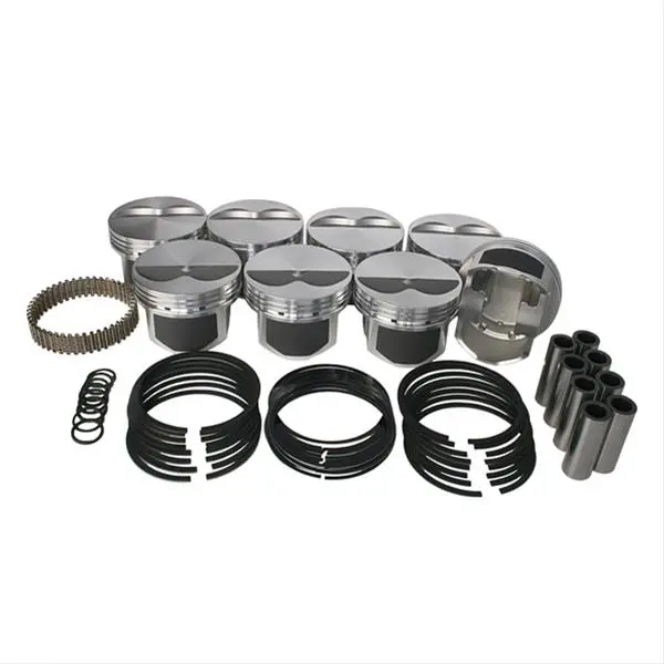

Another 500 gets him a .030 + set of 4030 alloy forged Pistons, pins, locks, and rings..
I'd just about challenge anybody here that I could build this engine short block for the price of a bare Dart block, and have new bearings, timing chain, oil pump, pan, and machine work all in.
