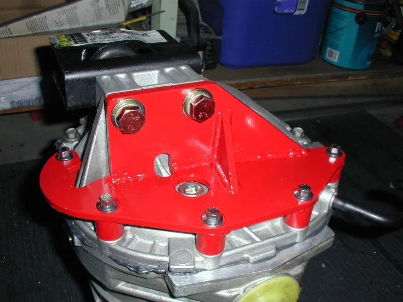

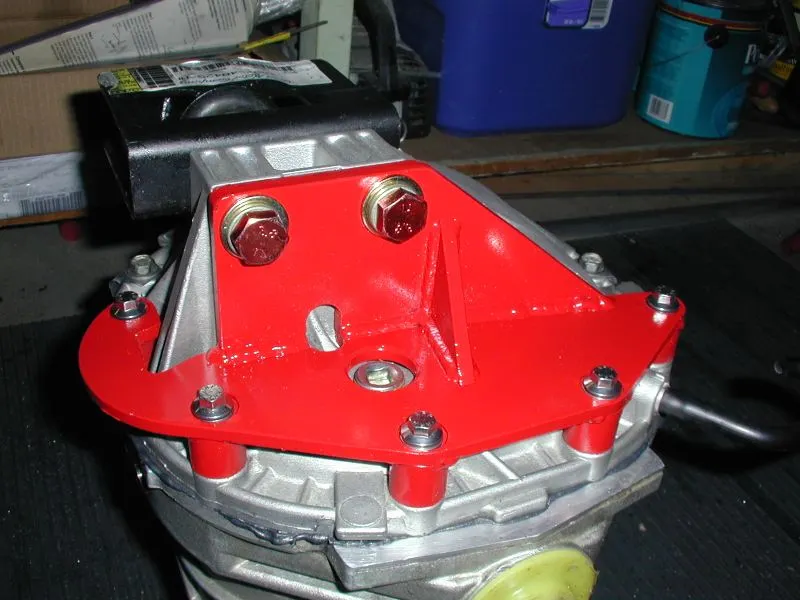

Can you recomend a good brand and source for both the Torque brace and the Differential brace? These will be for a 2001 Cobra.
Thanks
I'd get a stock 03/04 Cobra torque brace ($70 from Ford) and then get this differential brace ($150): http://www.billetflow.com/irs_brace.htm
U.M.
