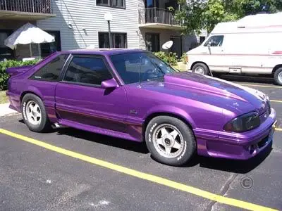

Here ya' go. Crappy pic quality, but hopefully enough to get the general idea. They're the only two surviving pics I could find of the old notch's side-exit exhaust; this was before I thought to add an extra 45* bend to sweep them backwards a bit (I'd just thrown a straight 18" length on the end of a 90* elbow on each muff) and also before I got around to adding hangers to the tailpipes to keep them from bouncing/thumping up against the frame.
Note that the tailpipes do not hang any lower than the mufflers, themselves, so there is NO loss of ground clearance over a stock rear-exit exhaust.
Also note that the paint on the car was much nicer than what I have on my current notch... :D
