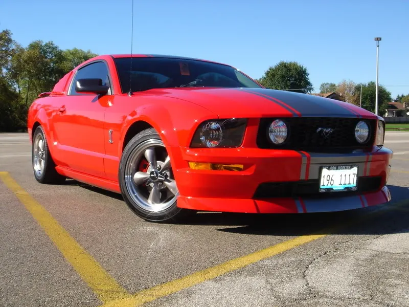

The 4:10s are now in...while I was at it, I decided to add a new rear end T/A girdle (larger), new adjustable BMR adjustable panhard rod, a panhard rod relocation bracket and new panhard rod upper support. Also added new BMR lower control arms with poly bushings and BMR tubular sub frame connectors. I also purchased a Diablosport Predator to load the correct gear ratio and their 93 performance tune. The car launches hard and now really hooks up in second. Unfortunately it's been in the 30's here in the Chicago area the last 3 or 4 days and my summer tires just don't do the trick in this freezing weather. It is suppose to warm up into the 60's over the weekend so hopefully I will be able to push the stang a little bit harder.
Just wanted to say to anyone in the Chicagoland area looking to have 4:10 gears installed that Speed, Inc. in Schaumburg , IL. did a great job and very reasonable pricing. Installation for the gears was $200.00 plus $25.00 for fluids. Can't beat that deal!!!
