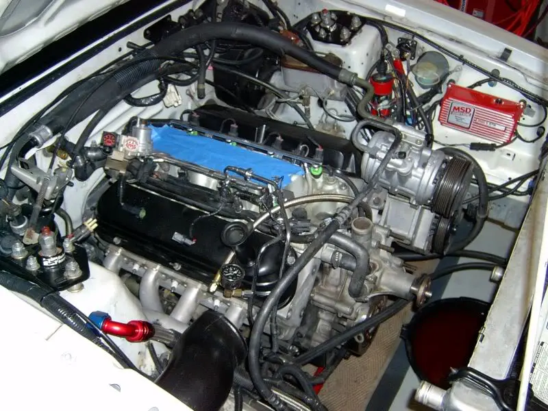

I guess I just need to get this thing out and see how it looks and go from there. Any idea why this would happen? The blower has only been on there for 2000 miles, so it's not like it's been abused its whole life. Before that it was just a mild 308 with H/C/I, daily driven. I even spent extra money for a H/V oil pump, 7 qt pan, main support , windage tray, SFI balancer, etc thinking it would help it last longer. I have the worst friggin luck...
Let the deconstruction begin! It never ends, does it?
Before:
Now:
