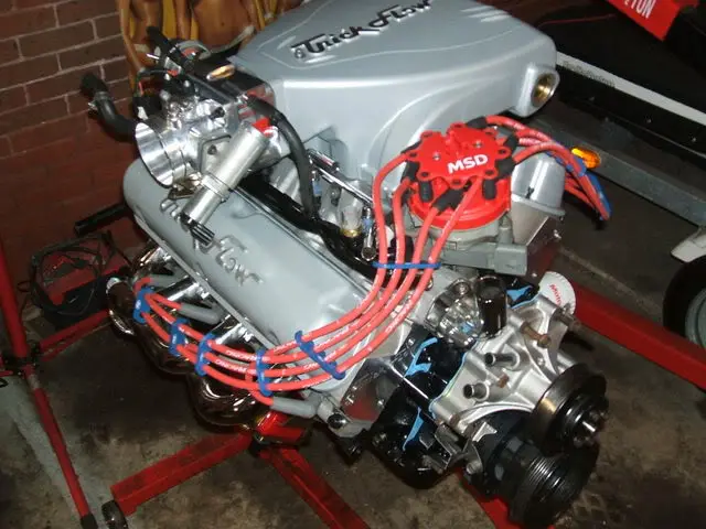

loss of power after H/C/I install. need help
it falls on its face if i do that

Could be
1. Timing Related (reclock distr. with a screwdriver in Cyl 1)
2. Cam Not installed correctly
Fuel seems to be fine if your getting 40psi and all injectors are plugged in
thanks for the responses. The kit came with new cam and timing chain and sprocket kit. Its impossible to install it wrong unless you wanted to. The timing sprocket only goes on one way because of camshaft dowel pin. Next I aligned the notches like your supposed to.
yeah i put the same kit on with all parts used except the cam.... and i had/have no aftermarket fuel parts and i still put it sideways comming out of the shop and scared the Poop outta myself.... something is wrong if you dont feel very large gains
edit to add have you ever ridden in an HCI car to know what it feels and drives like??
you really dont get any power till 3500 but i know that was said

I havent ridden in a h/c/i intake car, but ill tell you what, with my stock 302 it was able to do rolling 15 mph burnouts with my 373's. this is pathetic.

I but the engine back at tdc on compression stroke, and put the rotor one tooth over to 11 oclock and postioned the number one wire so that it is just about to get struck by rotor. As you can see in the picture in the first page that the distributor plug hits the thermostat waterneck at 15 degrees timing and wont go any further if the rotor is at the 12 oclock position. So that tells me that that cant be right. When i put it at 11 oclock it can get timed way past 15. Anyway. I took the car for a spin and it wants to go fast up until about 2-3500 rpm. It really moves out at 4000rpm to redline. during the 2-3500 rpm it wont get out of its own way. I cranked up the fuel pressure to 45 pounds this time too. I dunno
the rotor should be more towards 11 o clock not 1
and when correctly time the igniton module should be pointing around 4 o clock, no close to the water neck at all
just try to get it close as possible to number 1 terminal.

Nah bro, Im telling you, it is not accelerating at all, It walks up to 4000 rpm. It is slow. No balls. I think it might be fuel problem at this point. No way to tell unless i get a gauge for inside the car.

I bought brand new everything for under the hood. The only thing old is the short block with 65k original miles on it LOL. Im not buyin another thing for this car except maybe a box of SS109 steel cores for my ar-15 that will in turn deliver them to the car haha

yeah, it revs and is real responsive. Im gonna see if this mechanic down the road has time to look at it. They say this guy knows his way around fox body stangs better than anyone. Well shall see and ill let you guys know
