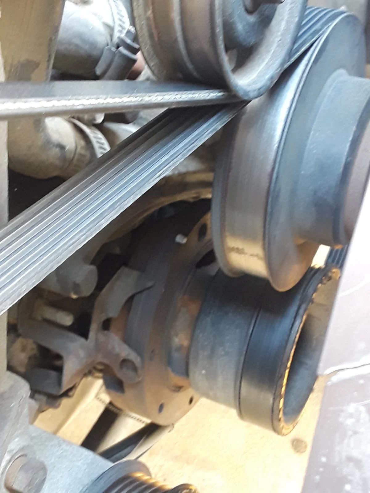

Ok, huge update. I was checking the drive belt and found that the belt was rubbing against itself. I'm going to include a pic so you can see what I'm talking about. I went back to the mechanic and he installed a different belt that seemed to solve the issue. However, there is still a little bit of power loss i would estimate that it's at about 90% now and I only really notice it when I'm at about 40mph.
