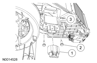

check your blower motor resistor, that controls your fan speeds,
The blower motor resistor can be accessed from below the RH side of the instrument panel,
it's common for condensation to build up when running the a/c on hi and drip on the resistor
shorting it out, it's possible that you had some water intrusion and it contacted the resistor,
I have replaced the resistor in my 91 GT a couple of times, but so far no issue with my 06 GT.
