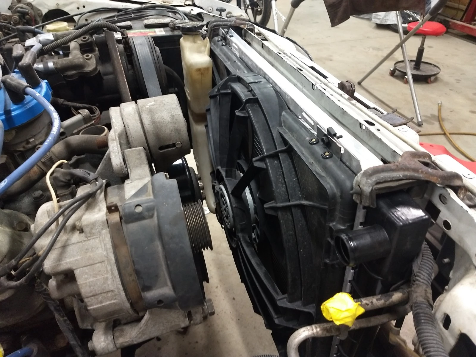

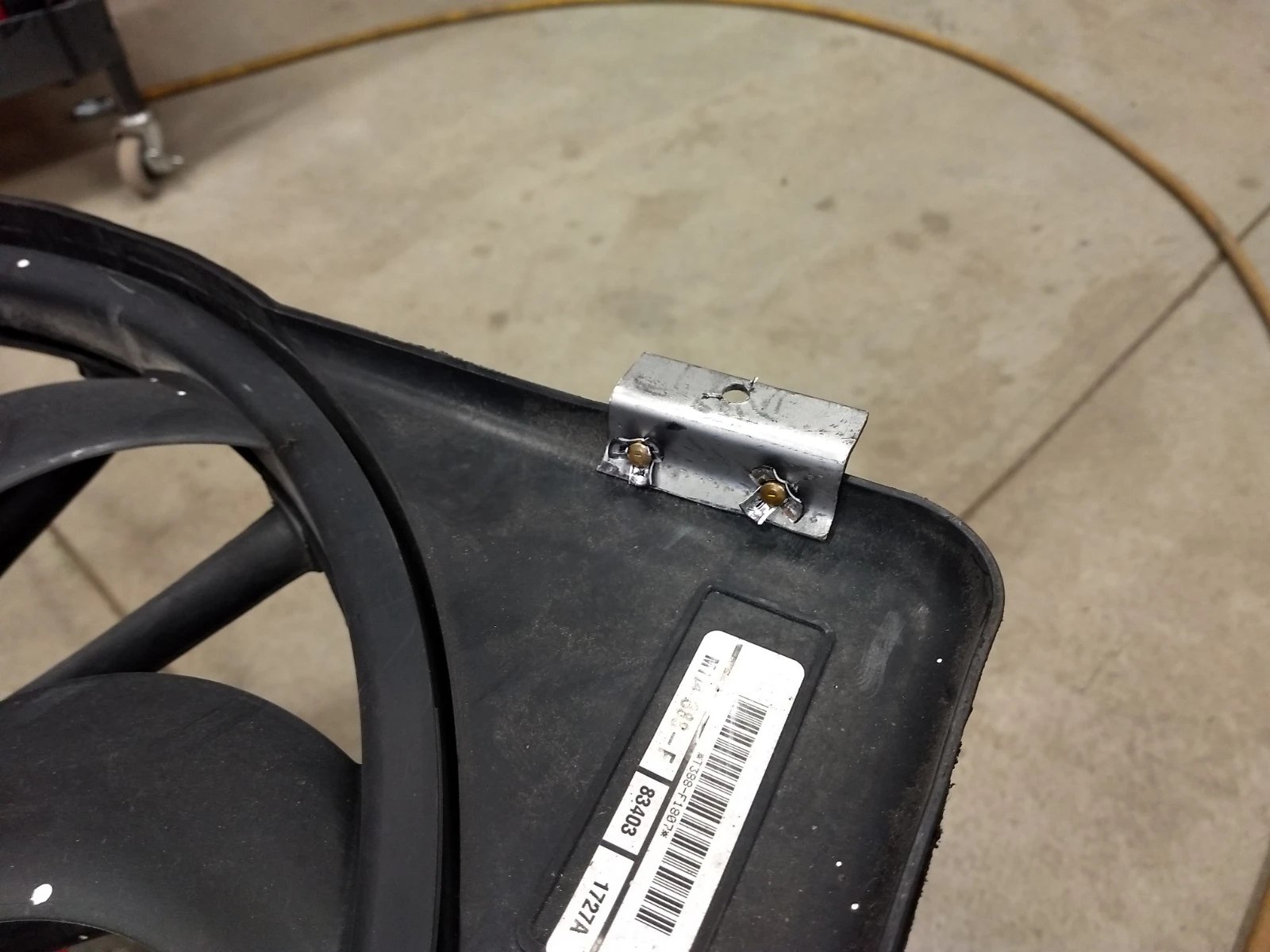

I've been working on reassembly here and there, I'm not going to make my paint deadline, and that's OK, the expiration date on the can is just a suggestion. I waited 25 years for this car, why get in a hurry now. I had the engine running the other day, but there is a pretty good fuel leak from the lines that run along the frame rail that was all rotted out, shocker right?

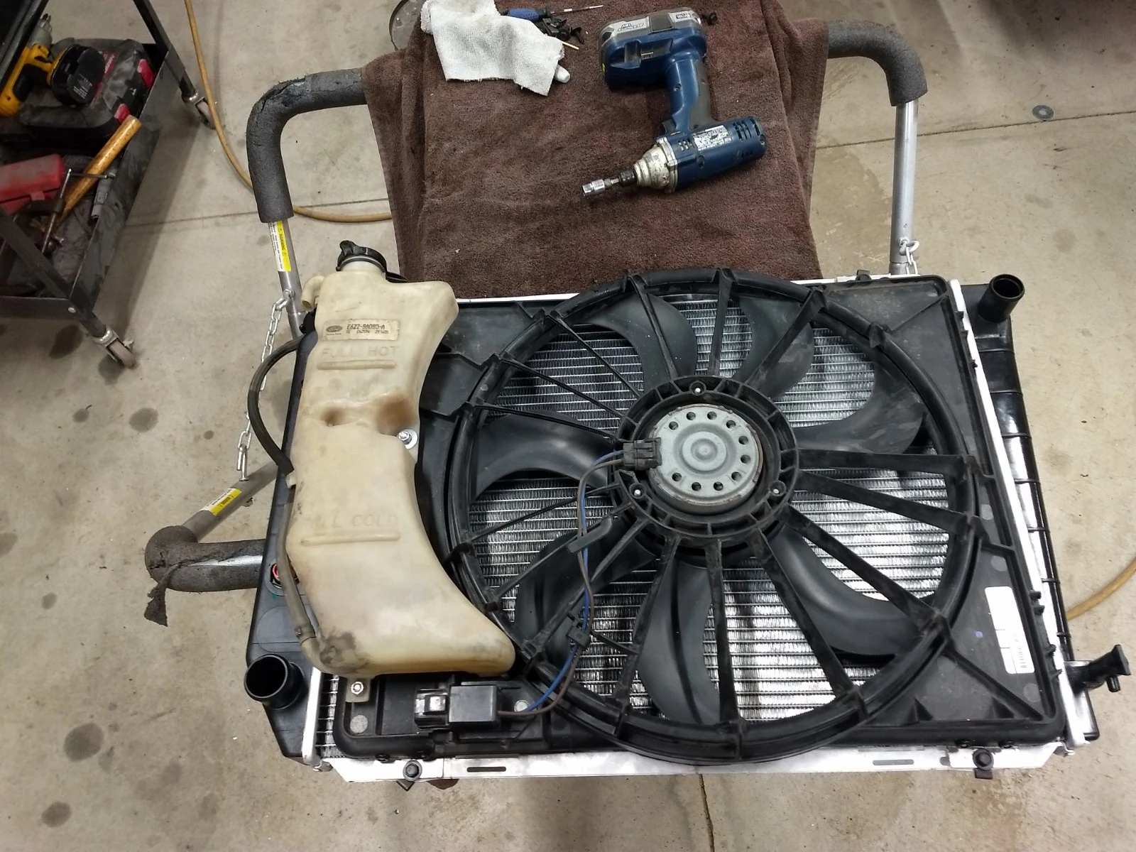

One of the few mods I'm doing is the electric fan from a Dodge Challenger that I showed before, so tonight I decided to make some mounts for it. I made 4 of these from 16 gauge Sheetmetal, they're attached to fan with 1/4 inch rivits, just like the ones that hold an outer door handles on. With these mounts, the fan bolts to the radiator pretty much same way the factory shroud does.
By mounting the fan upside down on the radiator, I was able to get creative and mount the factory over flow bottle, doing it this way also put the wiring on the driver side, closer to the battery.

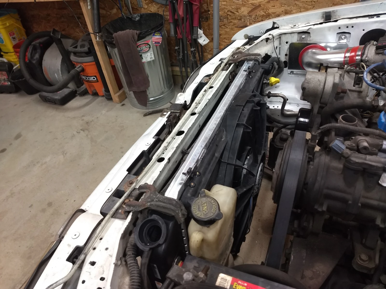

Here is a test fit in the car, I'm pretty happy with how it fits, and that I can use the over flow bottle
That's where I'm at for now, I'll pull it back out and paint the mounts so the don't rust, I also have a 3G alternator, and a fan controller to turn this thing on and off, but 1 thing at a time.

In my experience for some reason the 4 cylinder t5 holds up better than the v8 one. The last bunch of years I've gone through ( 2 ) v8 t5s ( 1 ) z spec t5...and the last 12yrs on a 4 cylinder transmission. My 347 made quick work of the z spec. The dog ears for second were worn off the gear. That would cause it to pop out of second. The detent blockers also started locking up causing it to not go in some gears. One of the v8 input shafts twisted and the bearings were trashed. The other one was due to gear oil and hard shifting when cold with bad synchros. This 4 cylinder transmission has been behind the 306, 347, and the last 4yrs behind my hardly driven 331 turbo. Guys told me the 4 banger transmission was stronger....this one came out of a 79 pace car in the JY. No idea what it was in before that. It's still living and working flawlessly.
I'm liking the fan install. Very similar to when I used the Jeep Cherokee electric fans....but I mounted them in the factory fan shroud.

Well, it's all back in 1 piece. I took it out over the weekend for some shakedown runs, and everything seems good. I still need to wire the fan controller, but for now it's parked over the lift, ready to finish body work.

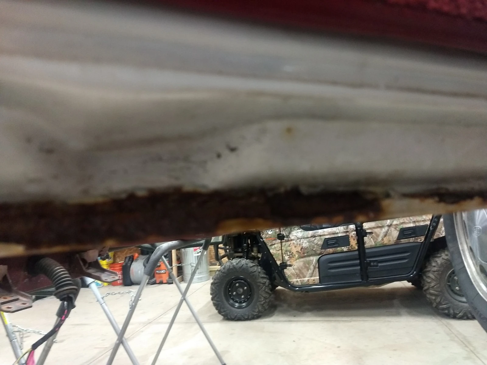

What's left for body work? Rockers?
Got a rust spot on the drivers side rocker, some rust on the door bottoms and a couple of door dings. Then detrim and final paint prep.

My rocker isn't that bad, I will more that likely just use some fiberglass filler like I did on the rear wheel arch. I know that isn't the proper repair, but summers coming and I want this car done. The paint job it's getting will just be one step above Maaco, but that's on purpose, the paint was free, so it fits my budget perfectly.
Inner and outer rockers is a pretty big job, what kind of shape is the floor in? Just wondering cuz the inner rocker welds to it.

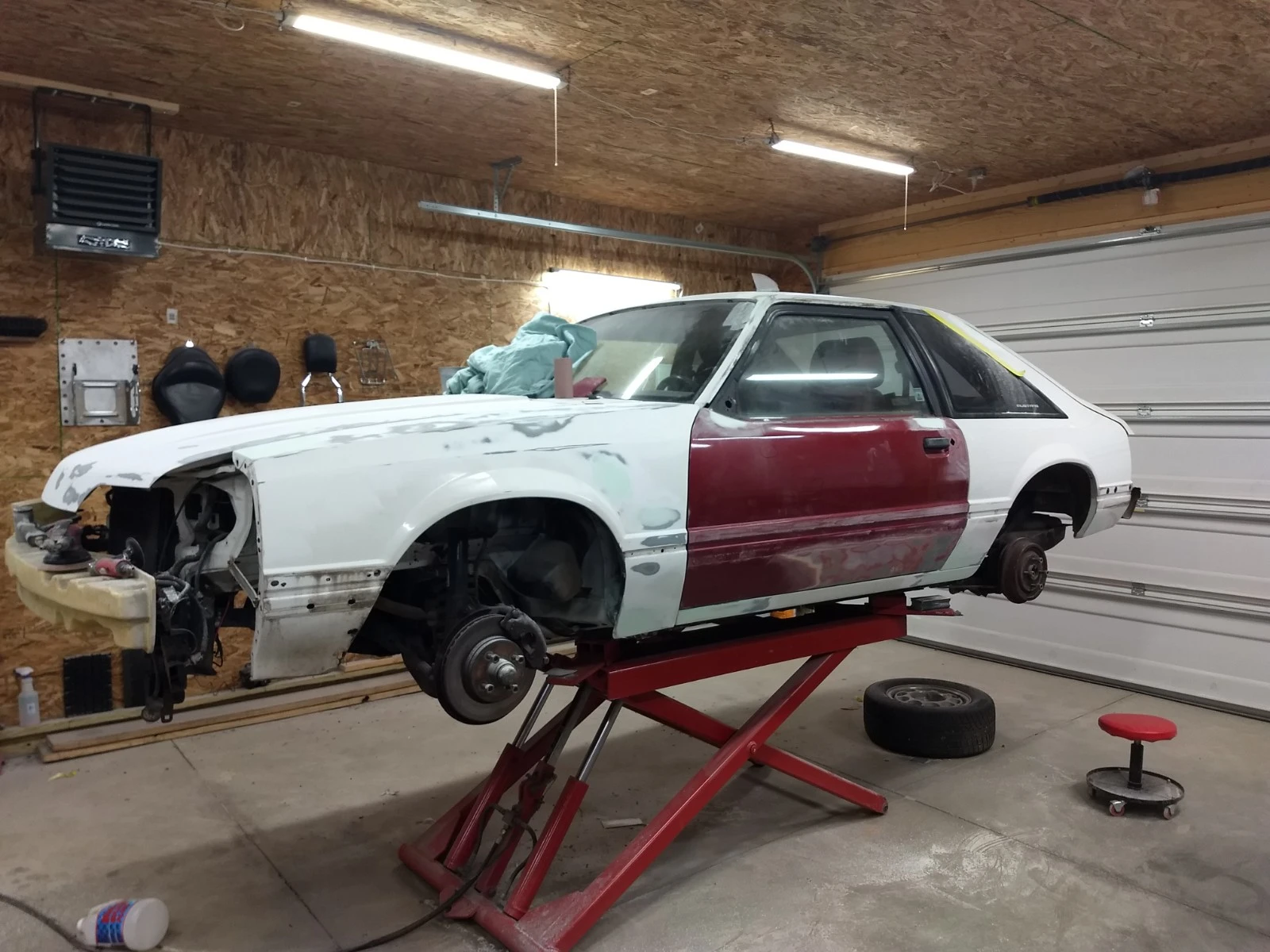

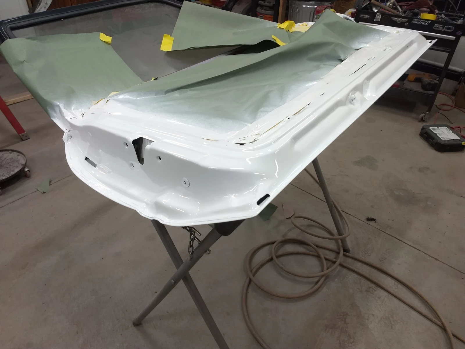

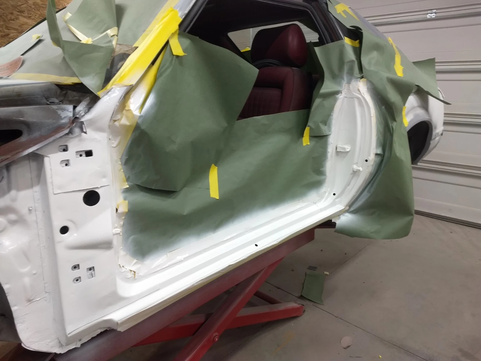

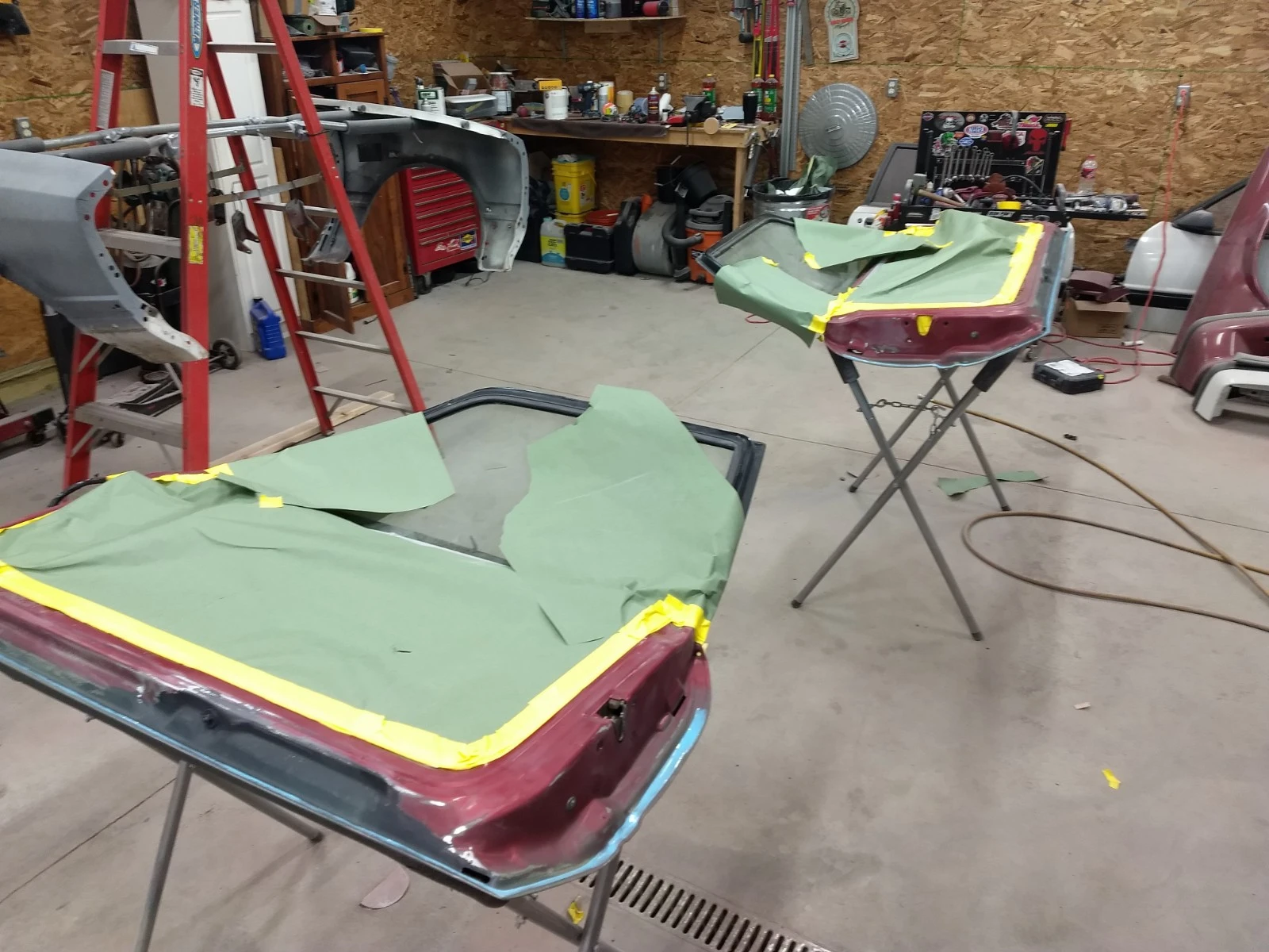

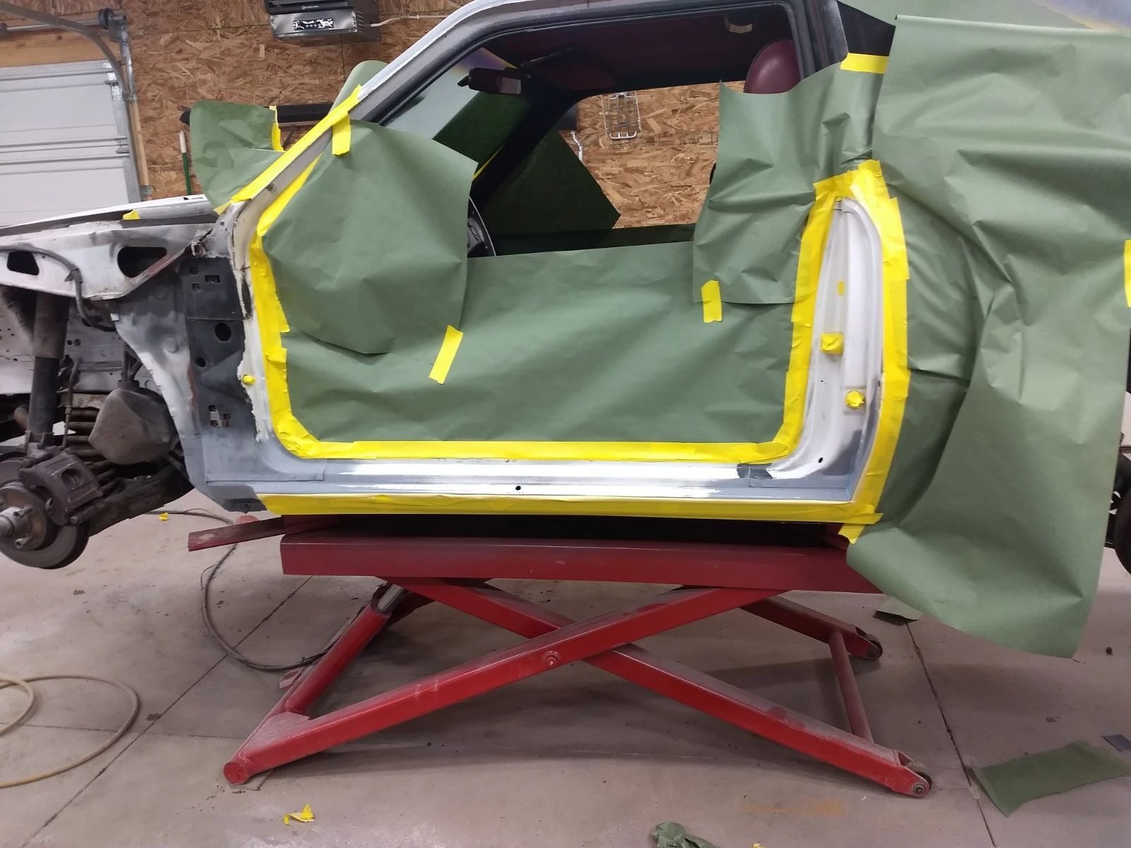

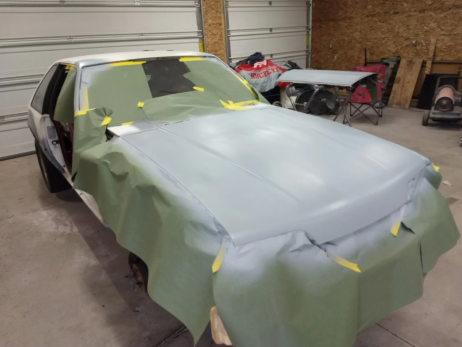

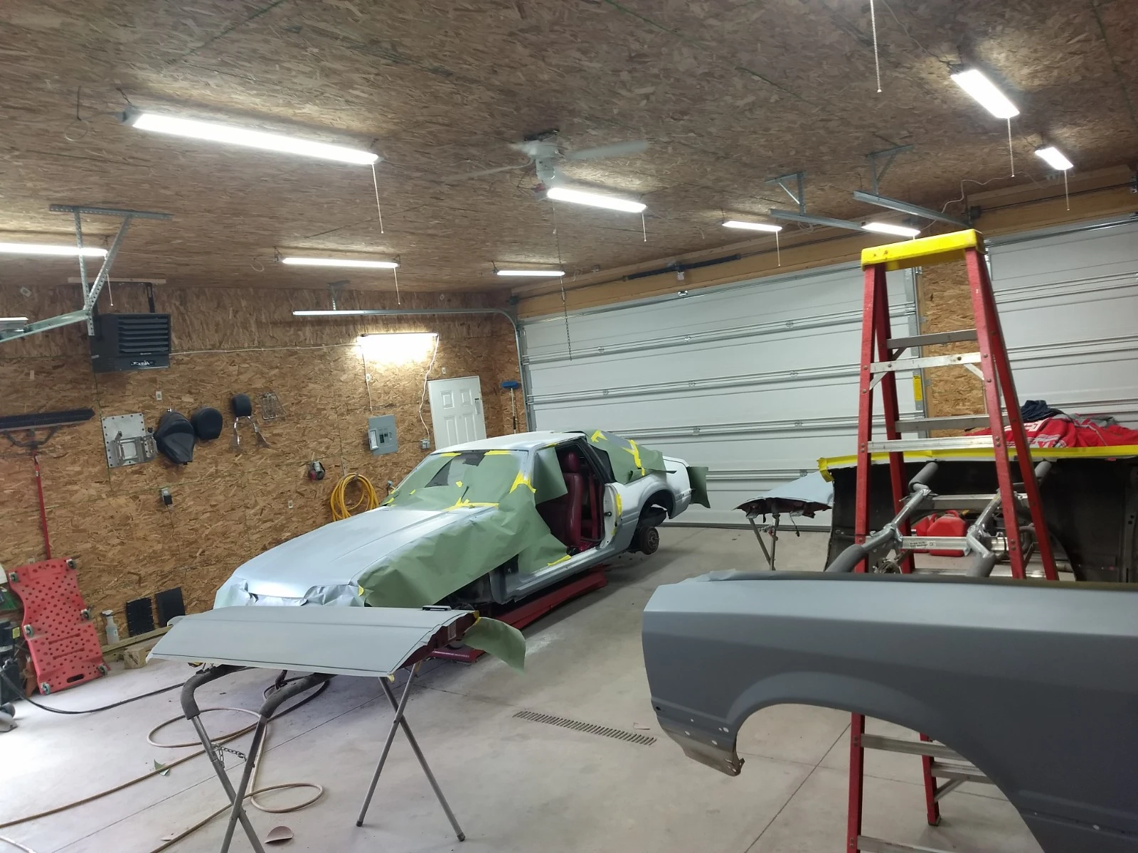

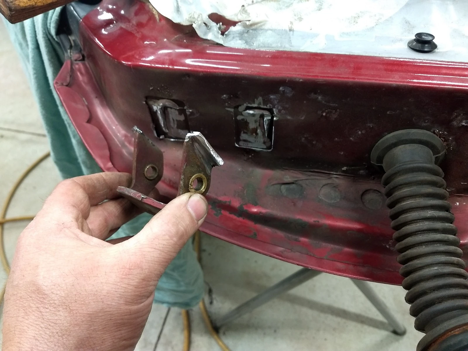

Update time, I've been side tracked with some other projects, but the Mustang is still moving forward. I'm not going to do a step by step, just an update and a big picture dump.
The day I started doing bodywork, I realized the doors were worse than I thought they were, a rust free set off doors popped up on Facebook, so I went and snagged them, I also got the front clip from the same car, I didn't really need it, but the guy said if I was taking the doors, I had to take it too. I had some fitment issues with the passenger door, it was sticking out about 1/4 inch from the cowl, I tried to fudge it, but ended up cutting the upper hinge off the door and welding it back on in the correct position. All of the bodywork is done, everything is in primer, and tonight I seam sealed the doors and cut them and the door jambs on the car in. I still need to remove the quarter glasses, hang the sheet metal back on, and prep the bumper covers.
I might try for paint this weekend, but I think that may be pushing it, I'm tired.

This is where I'm at for now, did I mention I'm tired. I went way farther with this car than I wanted to, this was supposed to just be a quick sand and shoot.
