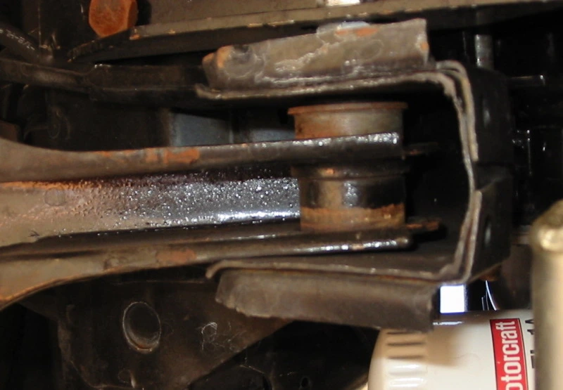

This may get long winded, as the issue is a bit difficult to explain. I am hoping for comments/thoughts to either confirm or dispute my concerns/fears and my intended solutions on my 68 Coupe. Pics first:
Right side not too bad:
Driver side not so good:
The problem, as I see it, starts with the LCA bushings being "pressed" into place. As the pics show, the control arms have moved/slid forward on the outer bushing sleeves, sometime after installation, with the driver side unit actually having the front, rolled edge of the arm make contact with the channel on the frame. This bushing is actually a loose enough fit to allow me to "slide/move" with a pry bar, the arm rearward and forward on the bushing sleeve. It is snug, but not tight. Another compounding factor, as I see it, is that I installed a camber cam eliminator/lock out kit. These kits do not have any type of shoulder or stop on the bolts to limit the amount that the frame channel gets squeezed together, unlike the OEM cam bolt/washer combination that will only tighten so far and then stop. It seems to me that if these bolts are tightened too far, they will squeeze this channel enough to lock the inner sleeve of the bushing, thus only allowing rotational movement by the flexing of the rubber bushing or the outer sleeve spinning in the LCA. I guess one question is, where is the movement intended,

i always tack the bushing in place i have seen a lot of them slip out, i believe the sleeve is suposed to pinch and the bushing flex doesnt seem right but that is how the rear leafs work as well, i know if the bolts are not loose first and the car setting on its own weight and then tightend the car will not settle right and there will be a constant load on the bushings, if you do tack them cool them as fast as possible so it doesnt burn the rubber
your idea is a good one, just remember to control your heat as much as possible, you dont want to damage the rubber bushing. a better option though would be to convert to a spherical bearing at that point on the lower control arm. i believe both dazecars and operntracker sell kits to do that very thing. and while you have the arm out, you may as well reenforce the arm as well by closing in the bottom of the arm. again dazecars and opentracker can help with that.
what switching to a spherical bearing does for you is eliminate the slop in the bushing for more consistency, and gives you longer wear than a bushing does, as well as being easily rebuildable.
Thanks Guys,
I had a very nice and informative 20 minute conversation today with John from Opentracker, about my planned repairs and plusses/minuses of most of the different options available. He is a WAY COOL GUY:cool: and not afraid to talk about others' products. What you guys said is identical to and total confirmation of what he thought and I had assumed. When I make assumptions, and see more than one possible option of what the truth is, I like to have the actual facts before starting /going off half cocked on a project. Off I go, with tools in hand!:banana:
Thanks Again,
Gene

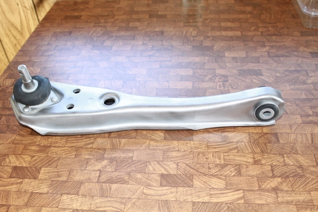

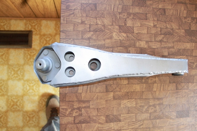

this is one of a pair of lower controll arms i was going to use on my 69 ,but i am thinking about a TCP unit now ,i plated the bottoms with 1/8 plate steel ,these should hold up as well as any tube arm this will stop any twisting or flexing ,i did these about a year ago ,dont know if you can see it in the pics but the bushings are already cracking i didnt tack them in place yet so i think i will change them with polly bushings and save them for somthing else

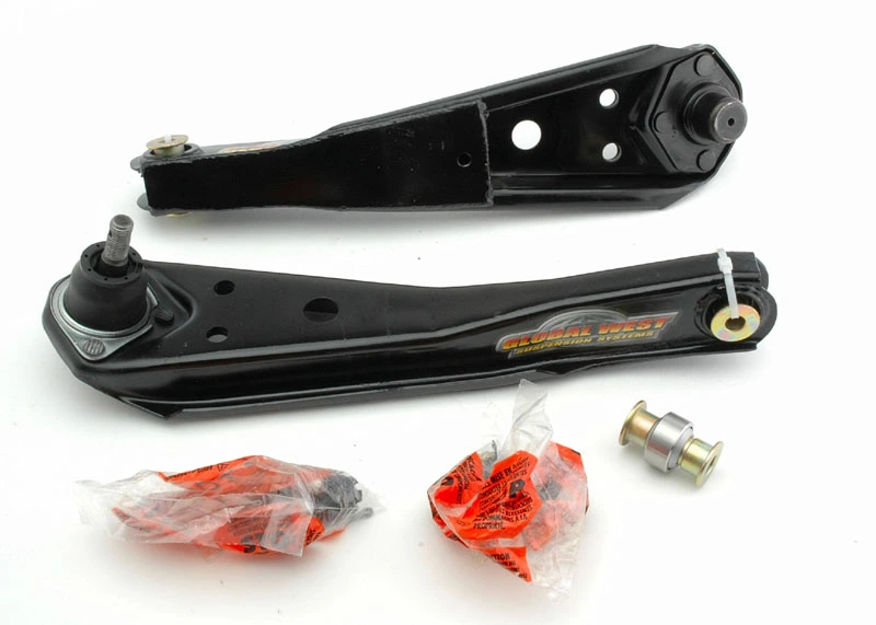

actualy the cost was practicly nothing for me as i have plenty of scrap metal laying around and any reinforcement has to be an upgrade especialy on the roads around here, is a globle west up grade or tcp kit money spent un wisly for a street car ?
