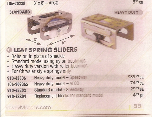

my 65 drag car is set up with a floater rear end ,if you would like to go one beter do away with the rear shackles and weld in spring sliders they do away with any sway that can occur with shackles ,the spring simply slide back and forth in the slider,they have bearings for smoothe action ,i think summit carries them as well ,or speedway

speedway motors

Ya... Sliders are cool! I'm familiar with the Afco, but hadn't seen the Speedway design until now. Looks to be a little stouter! I just need to decide how far I want to take this.... There's so many neat designs of suspension up-grades available from people like Hiedts, T.C.I., Maier, Griggs, etc..... Or stay with an Improved Factory style suspension....... What to do, What to do? It seems that the CalTracs would be the easiest solution at this time, because they don't alter anything in their installation. That way I won't have to Undo anything at a later date, if I decide to make some Serious changes....

wow check out page 94-95 in the speedway catalog,race oval track #335
bearing mounted floaters ,billet floaters ,oh the goodies ,i am thinking a full custome rear suspension when i get started on my 65 fb road racer looks like speedway has it all
