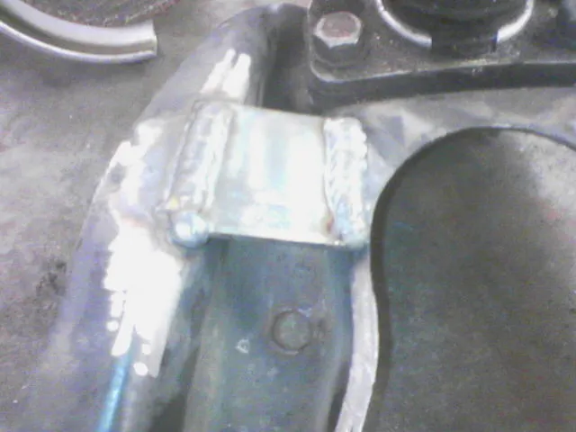

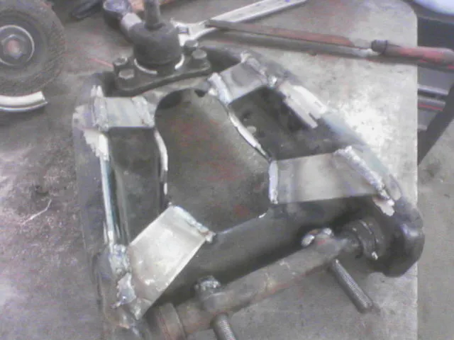

So I lowered my coupe. I did the shelby drop which was an 1 1/4 template, along with some cut 720 springs (guess theyre not 720's anymore). I somewhat boxed in my control arms. That should defintely add some rigidity to the arms, has anyone done something similar before? I will probly build a better set down the road that are complately boxed, I guess I am just gonna see how these work. Do many people have bumpsteer issues with granada spindles? I have a feeling I will, but I guess ive got to drive it and find out...

Opentracker does the bottom side bracing. http://www.opentrackerracingproducts.com/index.html
Cobra Automotive does this mod too, which you can kind of see in this pic:
Cobra Automotive sells the plates for do-it-yourselfers.
Maier Racing sells boxed UCA's, but they add material down the sides of the "A," not in the middle. I see that Opentracker does likewise on his "Autocross" UCA's.
