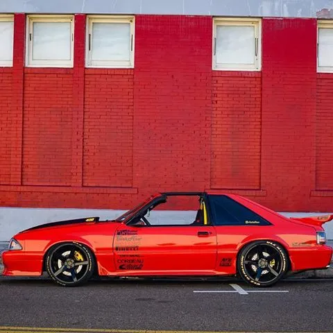

This is the ride height im after...it seems there may be some conflict with ridetechs shockwave mounting bracket and the panhard bar mounting location...
I will be calling ridetech monday to see if they have any info about this but looks like i might be stuck with rear coilovers
So basically im looking for the best suspension setup that yields both this ride height and handling for high hp (500rwhp now 750+ rwhp end goal) aggressive/cruise street car and the ability to run a wide wheel/tire (hopefully a 10.5 bc of the wheel i want to run)
