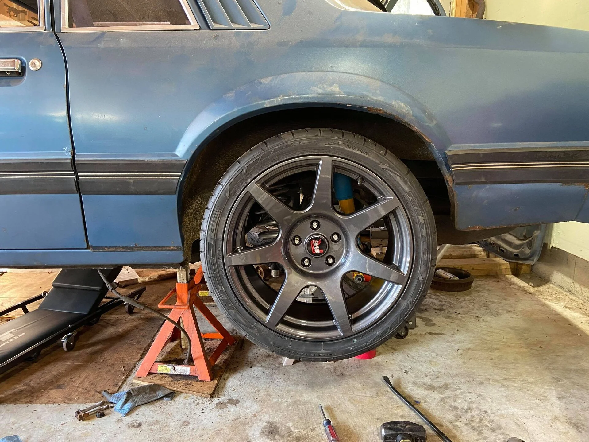

Hey everyone, I'm doing a crap ton of suspension work and an engine swap to my 82 4cyl so the car isn't street worthy right now, but I just put in my rear maximum motorsports road and track lowering springs with J&M height adjustable lower control arms and it definitely doesn't look like it really dropped the car the amount it should have which is .75"-1.25" on the rear...I just mocked up the wheel with the rotor to see how it looked, so no caliper or anything.

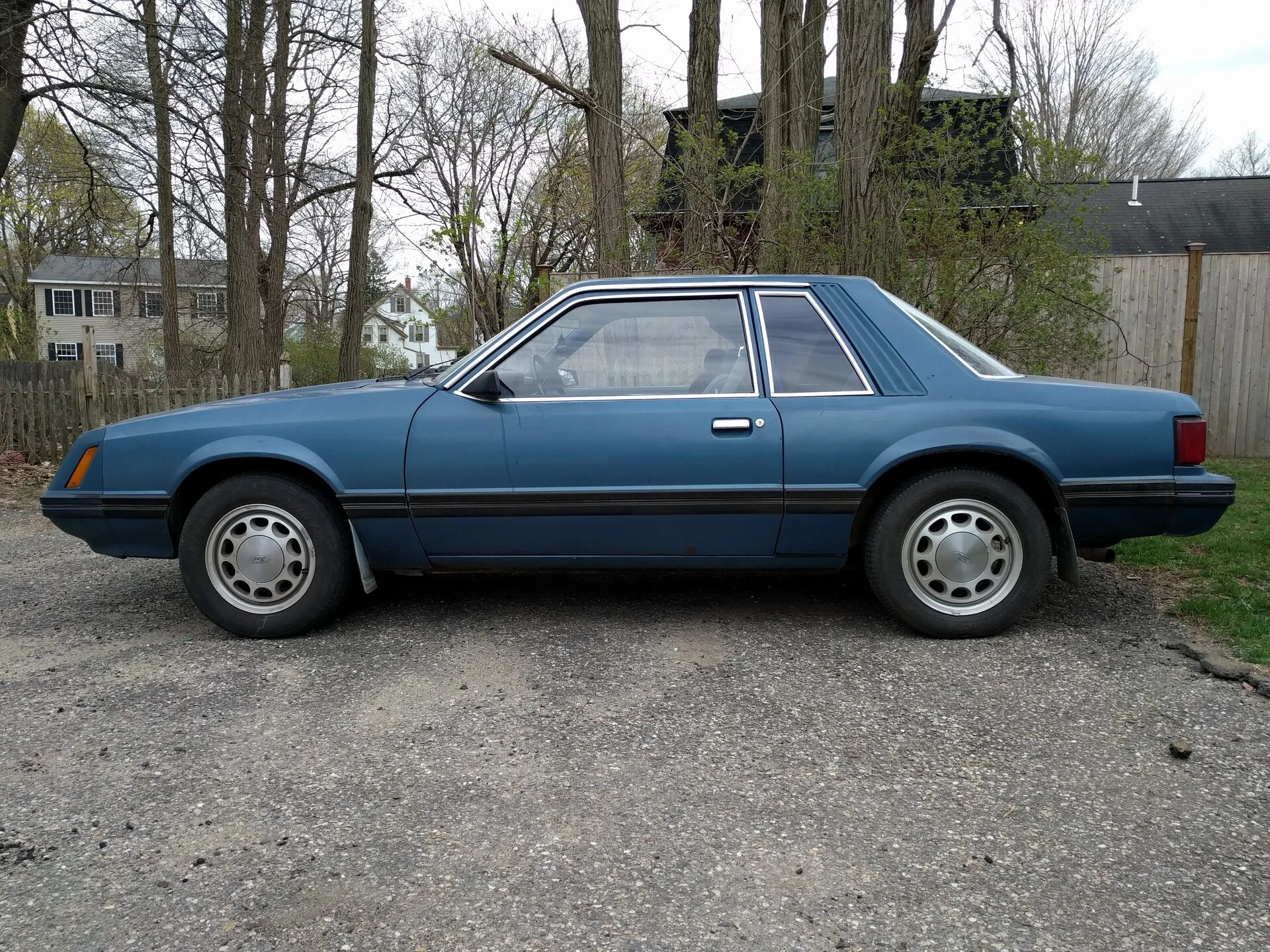

Now, this weekend I installed a newly built 8.8 rear diff, J&M adjustable upper (adjusted to stock length) and J&M Weight Jacker lower control arms and the MM road and track lowering springs. The wheel/tire combo is SVE r350 18X9 and nitto nt555 g2 265/35/r18 in one pic, and the stock setup in the other pic. The differential is jacked up with a floor jack so the weight of the car should be on the springs and nothing is torqued yet, and the pig tail on the springs are at 9 o'clock per install instructions. The upper and lower control arms SEEMED to articulate just fine when I was jacking the differential up and down, however I did have a pretty hard time getting the lower passenger side into the differential and was running low on grease, but it was still lightly coated. The weight jacker control arms are also supposed to give additional height adjustment from 1" drop to 2" lift but they are bottomed out...

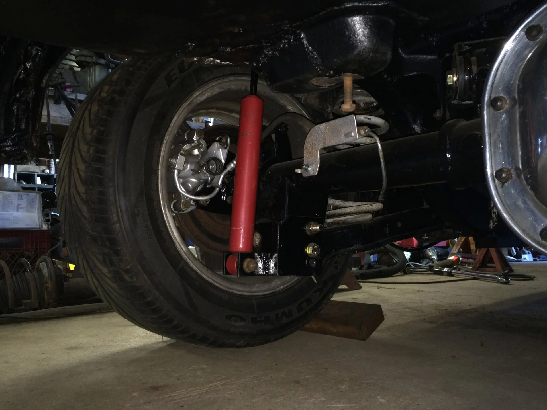

The jack stands don't appear to be free under the car. That would mean all the weight is not on the rear and the springs. If the interior is out or back seat and spare removed it'll make a slight difference.

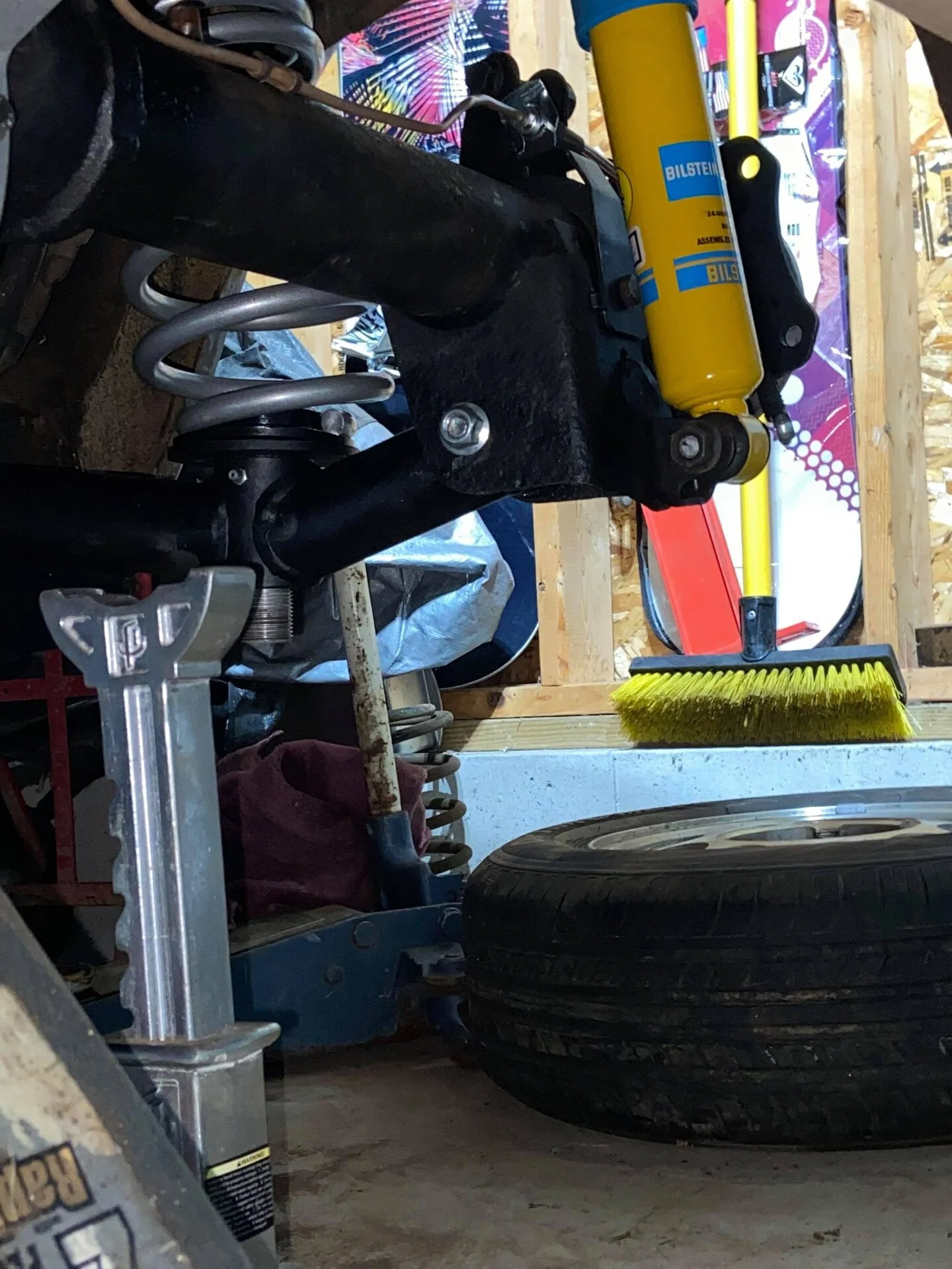

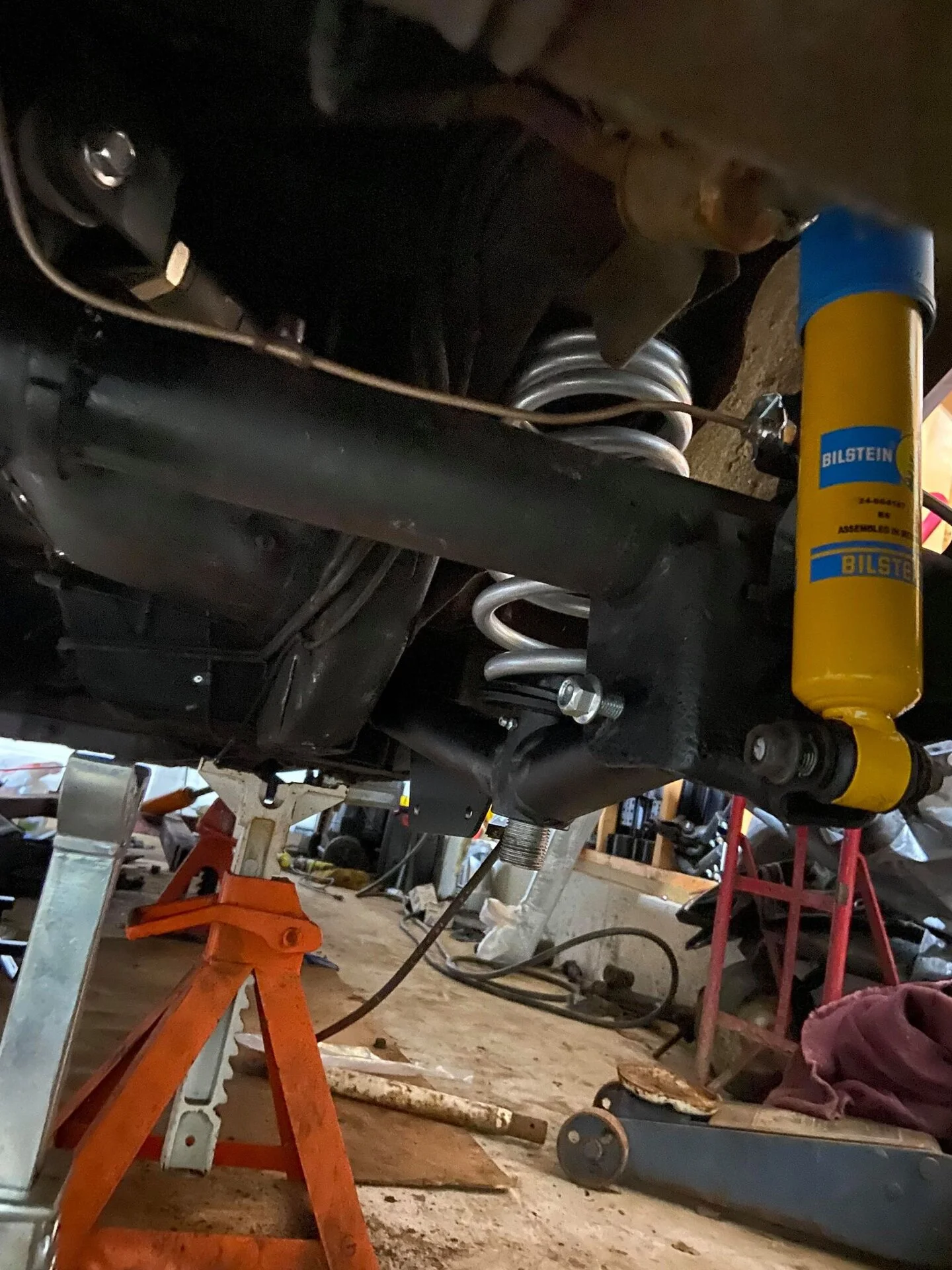

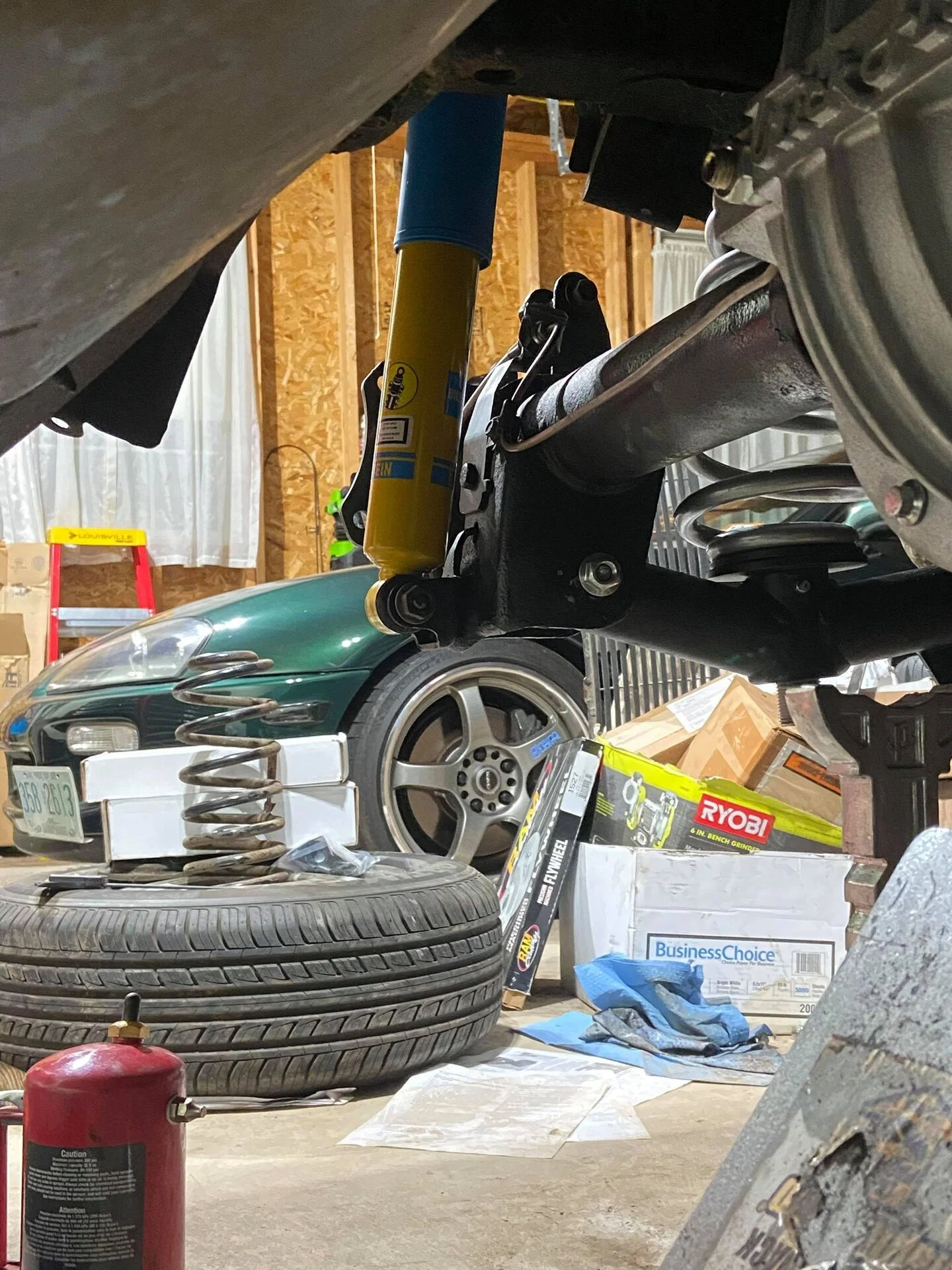

Can you get a pick from this angle...

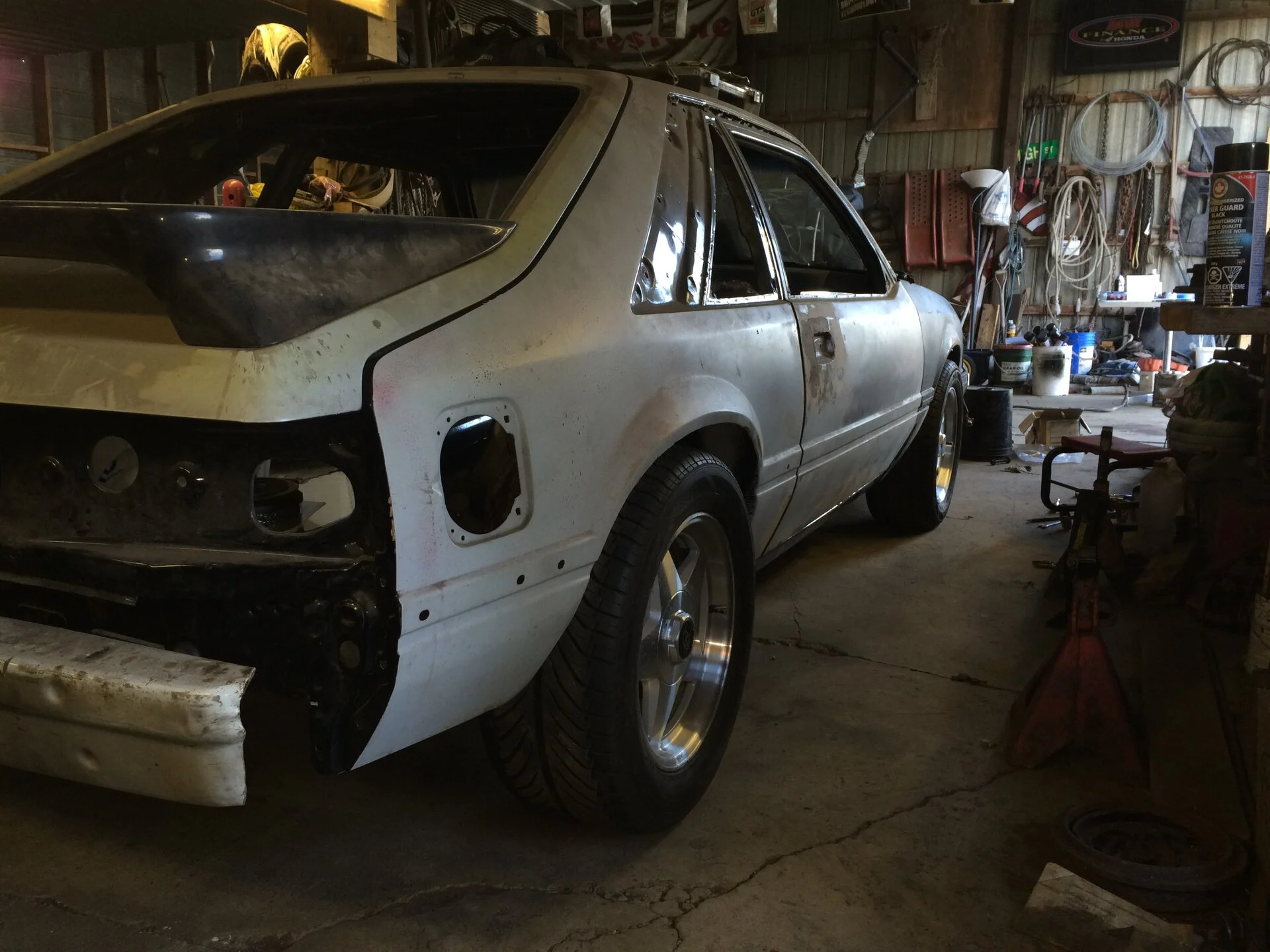

My set up at the time was reinforced stock arms with rear mount relocated down 1.75" and stock rear springs. Here was the car's stance with no interior, gas tank or side glass (doors had glass and hatch with no glass).

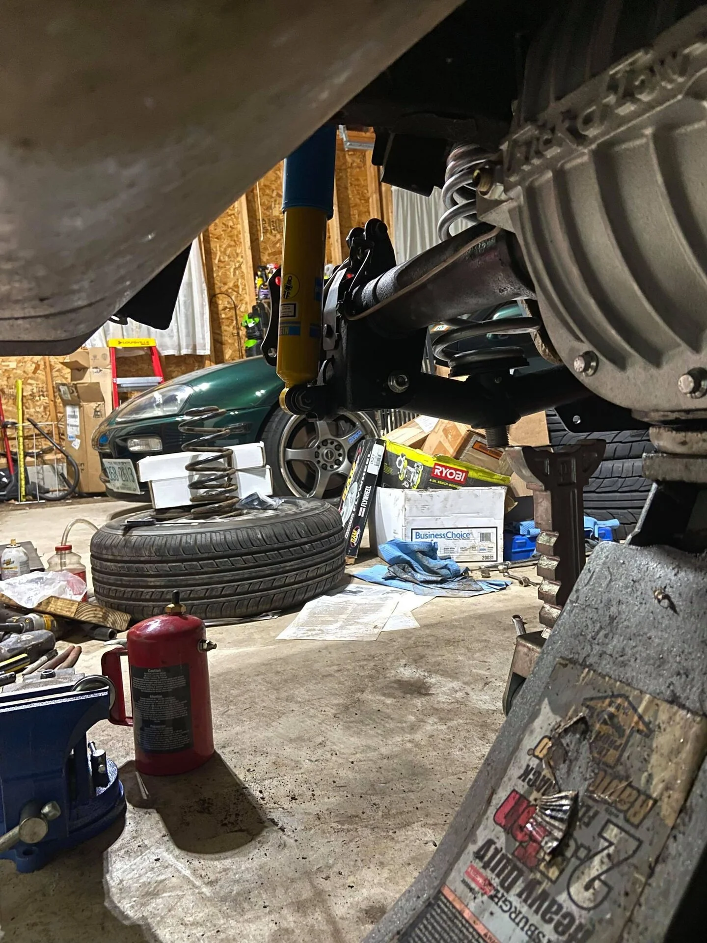

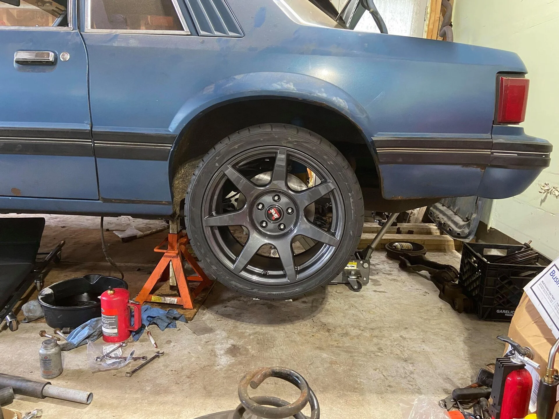

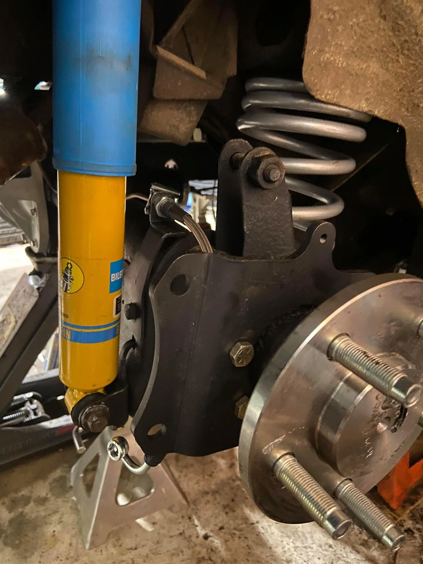

Kruisr, how's this? I got several pics of similar and different angles. What are you looking for in the pics?

Thanks for the pics. The main reason is it helps to identify if something seems off, which to me it doesn't.
Have you tried undoing one of the upper control arms to see if you are experiencing any suspension bind?
The line through the lower control arm mounts relative to the bottom of the spring looks like you have the base of the spring lower than stock, which should be helping you. Makes me think suspension bind. What rear upper bushings are you using (on the axle housing)?

I see adjustable lower control arms there, just like I have with the bottom spring perch that you can adjust the height on by turning the bottom threaded portion in and out correct? I see it threaded nearly all the way OUT. It needs to be turned IN so the bottom spring perch goes up. I have my threaded portion nearly flush with the bottom on mine.

I put it on the ground and nothing changed, the only thing i noticed was that one side was actually higher than the other, so that led me to believe there was some binding. So I took the diff completely out and noticed that the upper left control arm was super tight and it didn't line up with the bushings on the axle housing. I took them out, re did the 3 piece bushings on both sides of the UCA's since it looked like I put them in slightly crooked, and re-measured/adjusted the adjustable upper control arms to correct length. Put it all back together and now I have a decent drop!
