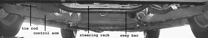

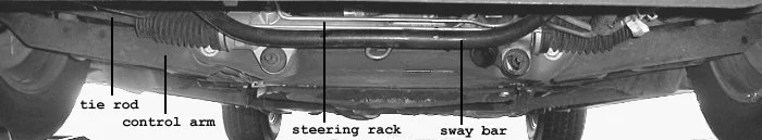

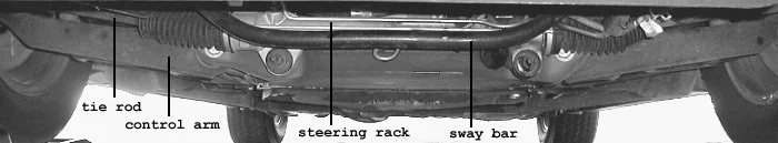

The picture above shows a 1979-2004 Mustang that has been lowered about 1.5" by installing aftermarket (shorter/stiffer) springs. Before it was lowered, this car's front control arms were parallel to the ground. Lowering the ride height by changing the springs caused the control arms to angle upward. This has a negative effect on front suspension performance. It lowers the front roll center, which increases the car's natural tendancy to understeer. It reduces the range of strut and control arm compression travel. It changes the alignment of the sway bar with the lower control arm. And it changes the alignment of the tie rod with the lower control arm. If the car is lowered much more than 1.5", this misalignment may produce bumpsteer, which occurs when the tie rod pulls the steering arm left or right as you go over a bump.
http://www.miracerros.com/mustang/t_suspension.htm
Read up if you wanna know about all that stuff. Basically you need matched shocks/struts to prevent negative effects, and of course that actually gives you many positive effects.
ok, i would have to agree with that site, however, a normal daily driver will not feel the effects of a 2" drop. rarely do normal people on the street take their car to the limit to even be able to tell whether the car understeers, oversteers, or is neutral. bumpsteer is a maybe as well. i had some for a while, but it turned out to be just the poor road quality. now i have none
