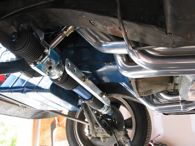

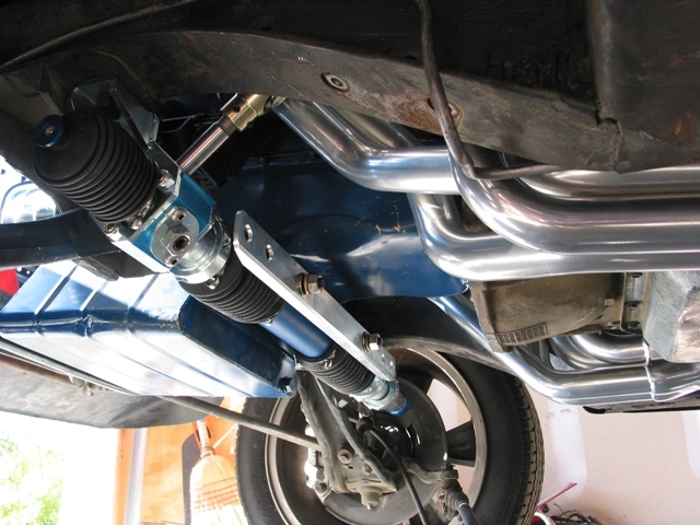

It should work but getting a full inch with the TCP rack is going to be REALLY tight. Here's a picture of my 351W in a 67, stock mounts, Hedman long-tubes. There's room in there, a 0.75 drop would work fine.

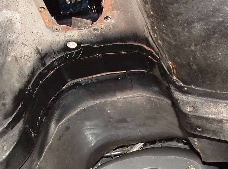

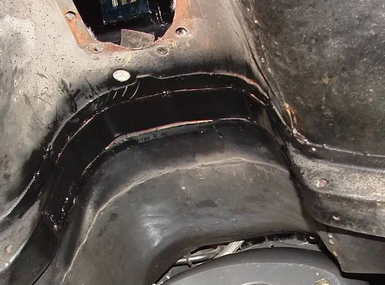

They do lower the engine a bit although I'm not sure how much. It can make the headers a real issue fitting between the towers. However it does virtually eliminate the need to do the complete tunnel mod with new sheet metal. But you still have to cut out the crossmember support and weld in some flat stock about 3/4 of the way up the tunnel... A little trim job on the front of the shifter hole as well...
