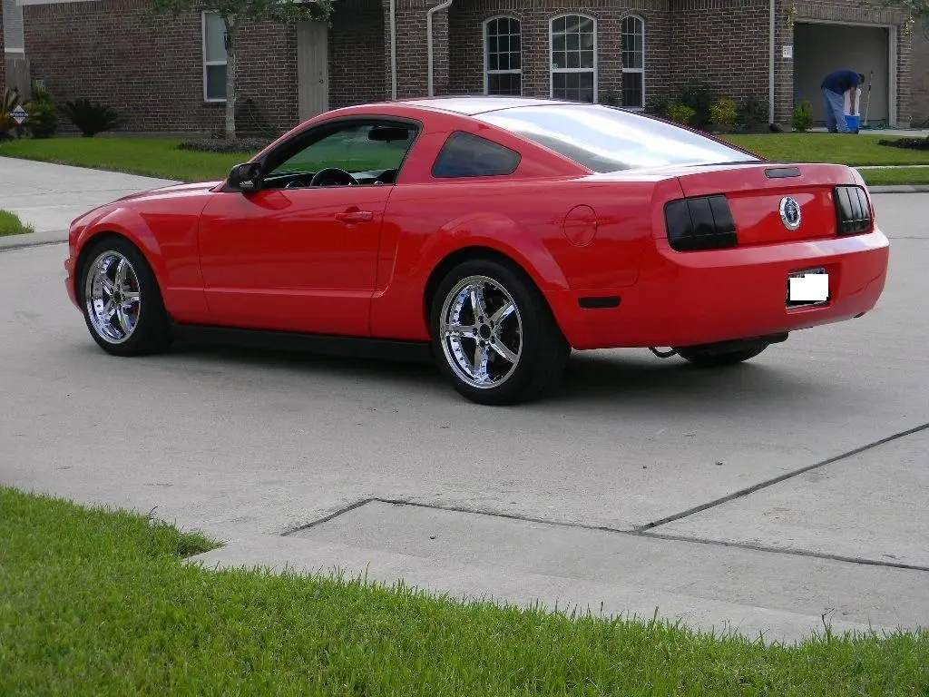

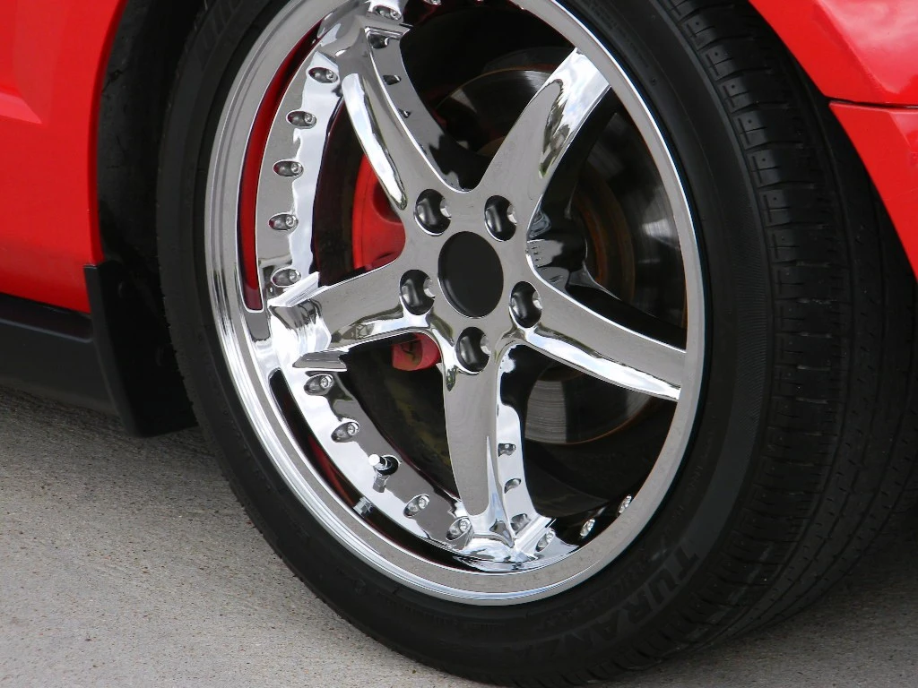

well here is my 02 cents :) I dropped my car 2.5 in rear anf 2.0 frt it looks great and still rides good . All I did was the springs still have stock struts and shocks . I will however replace my struts and shocks cause there old and I believe it will ride a little nicer than it does with stock struts/shocks . I know saving the money on parts is a good thing but remember you get what you pay for so don't go too cheap and as far as how far you drop it is up to you and how you want it to look your choice . I personally don't see any difference in a small drop . I do agree to adding caster/camber plates and adjusable pan hard bar cause I see a treadwear thats not normal with my extreme drop . Here is mine hope it helps ya :D [/ATTACH]
