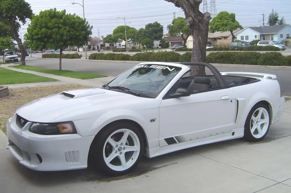

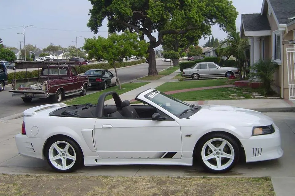

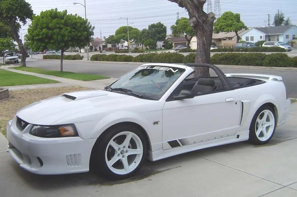

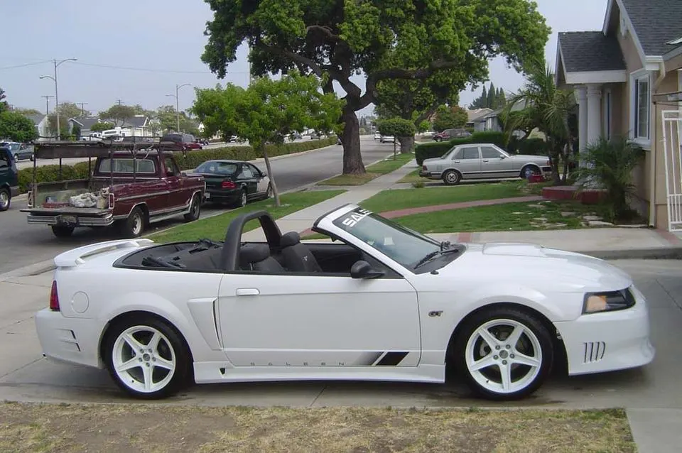

i jsut got done with an installation of some steeda sport springs on my car today....already i see a nice drop...

Nice, how much of a drop were they advertised as and how much do you think you actually got?
they claim 1-1/2 inch drop but people get 1.75 inch drop...i think in my pic thats a bit more than 1.5 inches...and i didnt replace my shocks and struts and everything seems to be goin good...
