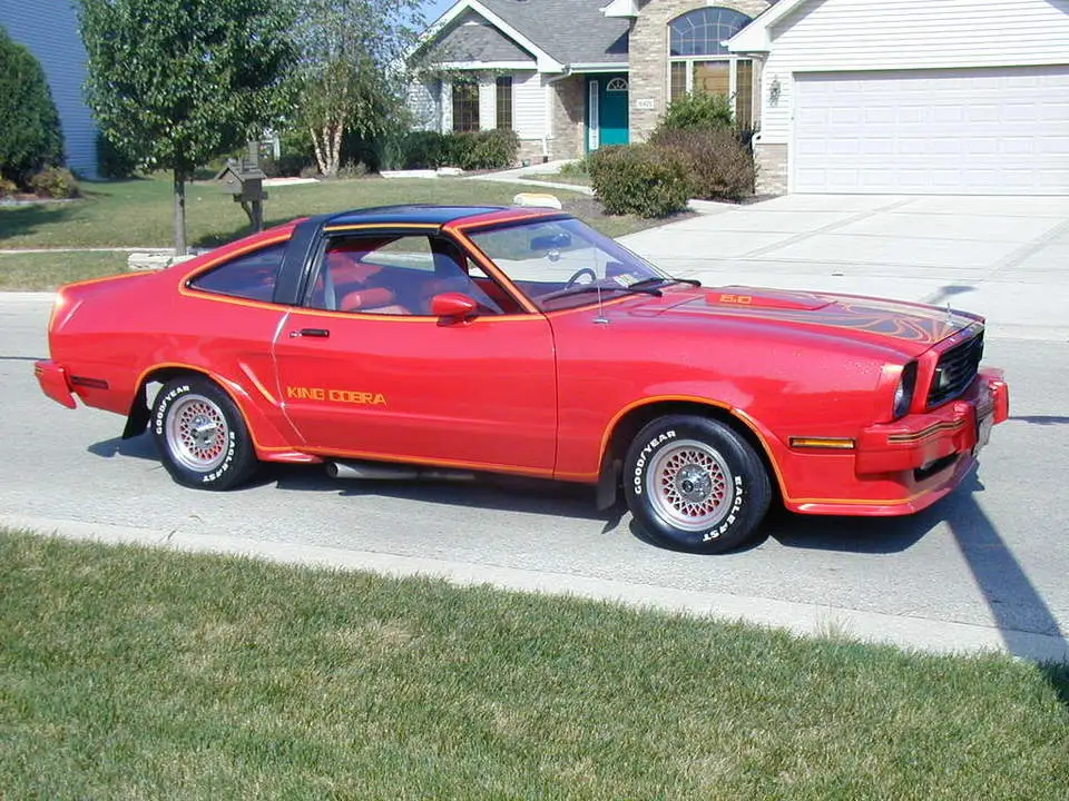

well i hope the pics come out good.

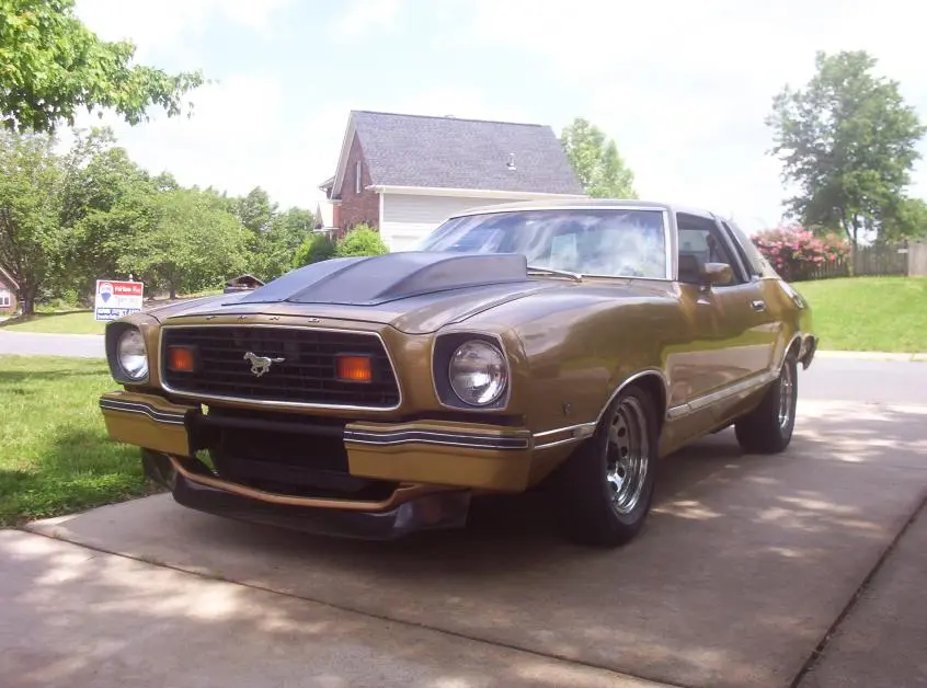

I would absolutely love to lower mine but are very concerned with the clearances. Right now, the mufflers sit soo low that when I pass a stone, it "clinks" under the car. If there is a bump in the road I get scrapes. What are you guys doing differently?
I dropped a 351W with aluminum heads and all the goodies to save on weight but it still rides too low. ( I also added a be cool aluminum radiator which did not fit properly) a different story for another day
My header collectors are 3-4" from the ground. Take a look at the photo of the car. I had the exhaust run just in front of the wheels only because I felt it looked cool.
I believe the shocks are all original but do not feel they will make that much of a difference.

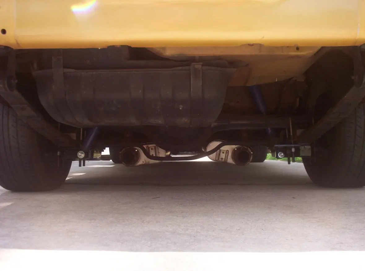

Unless you stuf those mufflers into the pocketed areas under the rear seat, be prepared for a muffler bash fest. Even glasspacks tucked tight to the driveline are targets, but not as bad.
Most of the IIs are ran to the rear axle and dumped before the rear axle. Or they are in the stock location to the right of the gas tank. There are a few that have it dumped in front or the rear wheels, similiar to what you did. Not a whole lot you can do with these things.
Here's what I have for now. It's 2.5 mandrel bent with 3" from the muffs back.
I want to change the section from the muffs back and either put in a fuel cell and run the pipes straight out the back or leave in the stock tank and just go with stock 67-69 Camaro bends.
