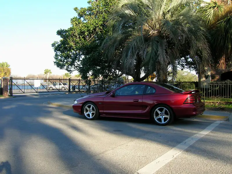

OK, here's my opinion. Its definitely unnecessary to get the X2's for the added drop. While it may be another road to get there, it sounds like its not worth the money at this point in time. On my old car, like I said I had Sportlines and I ran them with no isos at all in the front, and only one of the iso's in back (can't remember which one). Regardless, the cheapest and easiest way is to remove the front iso's for sure. I promise you that you will be satisfied with the added .5" or so. Here is a pic for reference for you:

car looks really nice. good stance to it. you and hanky are both right about the shocks/struts. i know the oem replacements are not the best for longevity but they do work. i knew before buying them that they would wear out faster with a lowered car but i know ill get my moneys worth with them also.
thanks for the pic. did your car sit noticeably higher b4 you took them out?
