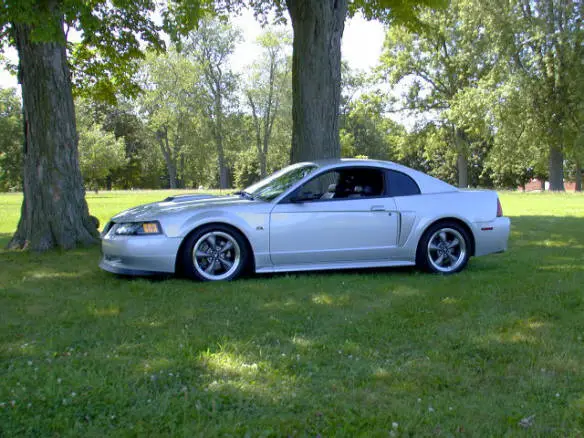

With the 2" drope,be prepared to be carefull around speed bumps,and certain slops on driveways and entranceways to plazas .
And you will also need some C&C plates to get proper alignment.
I have the Eibach sportlines.The drop looks sweet! Can be a headache at times,but it's the price you pay to look good.
Pic in attachment.
