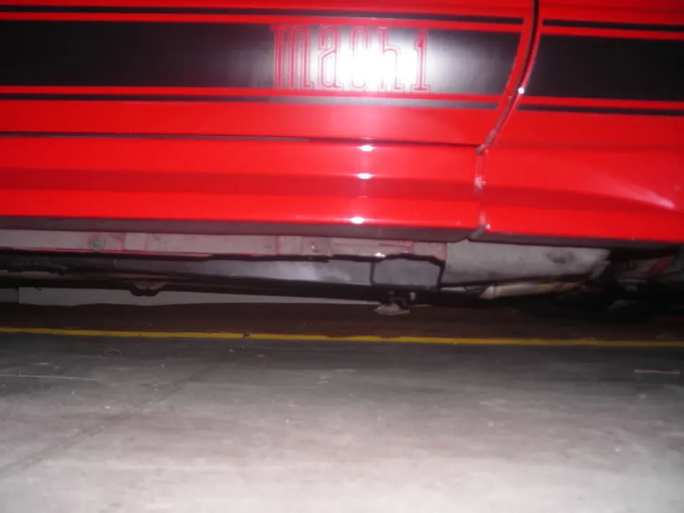

My car is lowered over 2 inches on coilovers & I have Mac LT's & havent scraped them any worse than I scraped m catted H pipe. Granted, my car isnt a DD, & I do drive carefully since I did the LT's, but i havent had any problems yet.... If you are worried about ground clearance Mac LT's are the ticket. They are also great quality for how cheap they are & u will notice a huge increase in power, or at least I did.... Kooks, SLP,BBK, & Hooker all hang pretty low & could pose a potential problem.
The one thing to remember is that Mac & BBK both wont allow tranny removal once installed, so u might want to make sure your clutch is in good working order before you install the LT's because the tranny will not come out without removing the LT's...
In this pic u can see that they barely hang lower than my subframes...

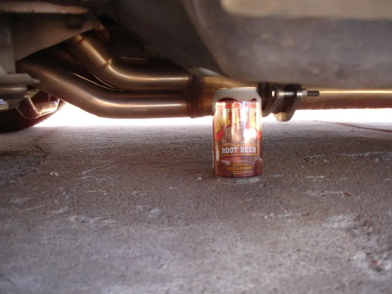

Now that I look at Deftsounds pics of his BBK's, they dont look like they hang down much further than mine...BTW Deft, u need subframe connectors on that beast, u have more power than me:D....
those are old pictures, i have mm full lengths like you now
