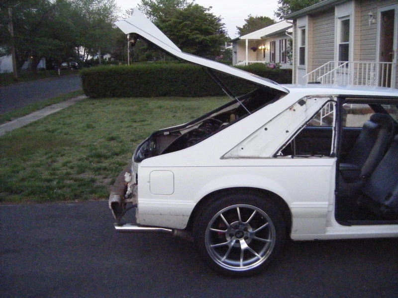

Decent side profile pic

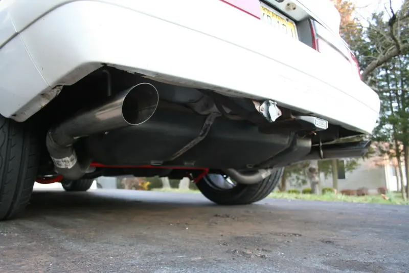

I have a Pypes Pype Bomb catback on my LX, fitment is good, sound is great, only real downside is the tips are rather huge.
Pypes Pype-Bomb Mustang Catback Exhaust SFM29V (86 GT; 86-93 LX; 94-04 GT, Mach 1, Bullitt) - Free Shipping
I got used to it though after looking at my GT with it's huge tips.
ETA: Only pic I got.

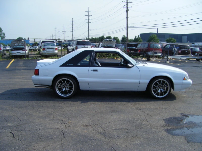

I only have a side profile on the Flowmaster kit. There is a slight difference from side to side that I notice. They system has been on for over 5 years and they still look good fwiw.

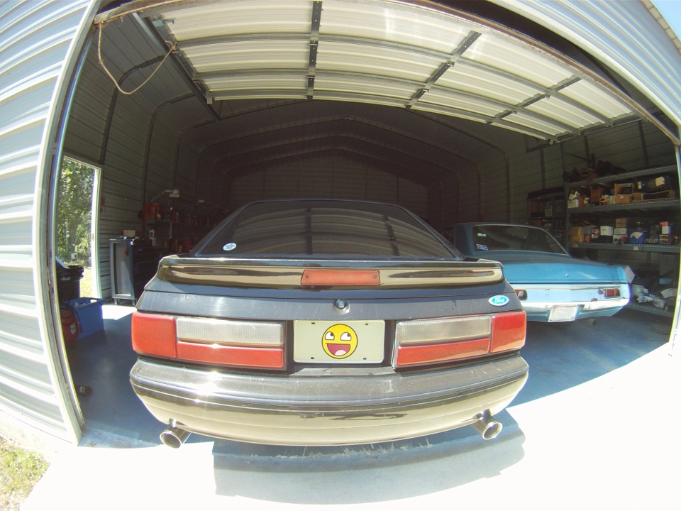

Man I just must have that one dang kit that sucks.
This isn't the best angle but here is the Flowmaster kit after about 6 hours (Installed H pipe too so that took a little time naturally) of work to get it to fit under the car.
