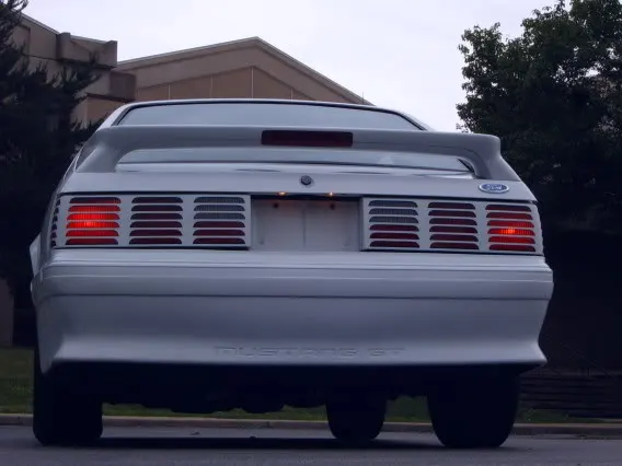

Here are a few pics of some LX's I have had and the way the spoiler fits. The GT one is designed totally differently so the entire appearance of a GT wing vs LX spoiler is different. Don't mind the damage to the car in the last one. That's proof of why older people need to be re-tested in order to retain a drivers license.
as a comparison, how a gt is:
the gt wing sits more on top of the hatch while the lx kinda wraps around it.

Quick91LX thanks for the pics. Now I see what is meant by the spoiler kind of wrapping around the hatch instead of sitting on top of it. It does kind of hang over the sides and the rear of the hatch.

A pic is worth a thousand words. I have all GTs so it's been a while since I've seen an LX in person. Thanks for the help guys.
