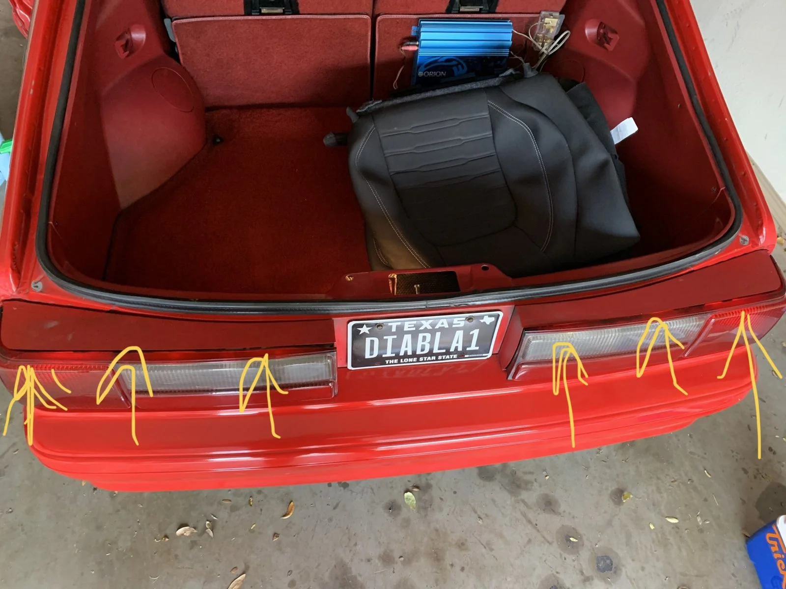

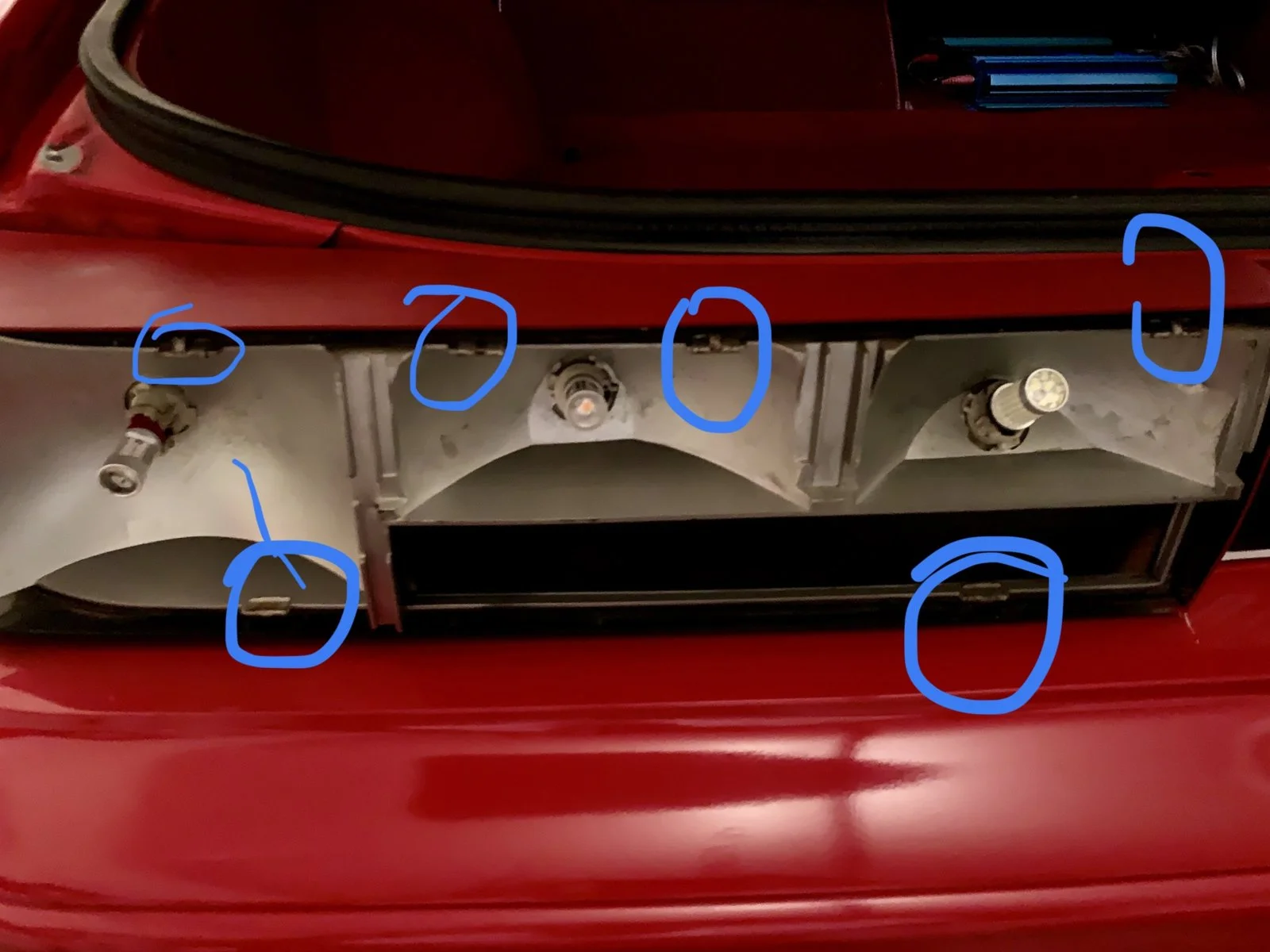

Here’s my question, on the actual housing my tails are pretty good, but are cracked and I’m thinking about swapping over to cobra tails. Any ways on the actualhousing where it clips in, are those little clips repairable? I like my original housing because they are red.
Are you talking about the tabs on the housings where the metal clips "bite" Devil? If so, you might need new housings.

Yeah on the actual housing, where the lens pushes into then that parts I guess bites down. Back in the day it was a thing for people to just come pull your lights off during high school, bc all the GT guys wanted to swap to LX lights, guessing at some point some one messed mine up, to which I used an anti theft device “screws” so they couldn’t just run up and do the pull & snatch. My passenger side is fine still but the drivers needs those screws to keep it in place or the lens will just fall out.
If those tabs aren't there I would shop for a housing. You might be able to get away with it if there are just a couple missing, but there aren't many there anyways.

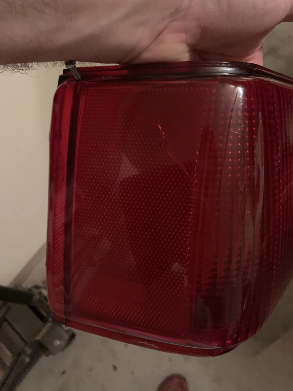

You said the housing is cracked, but want to keep them because they’re red. They’d be fairly easy to fix. How large are the cracks (picture maybe?).

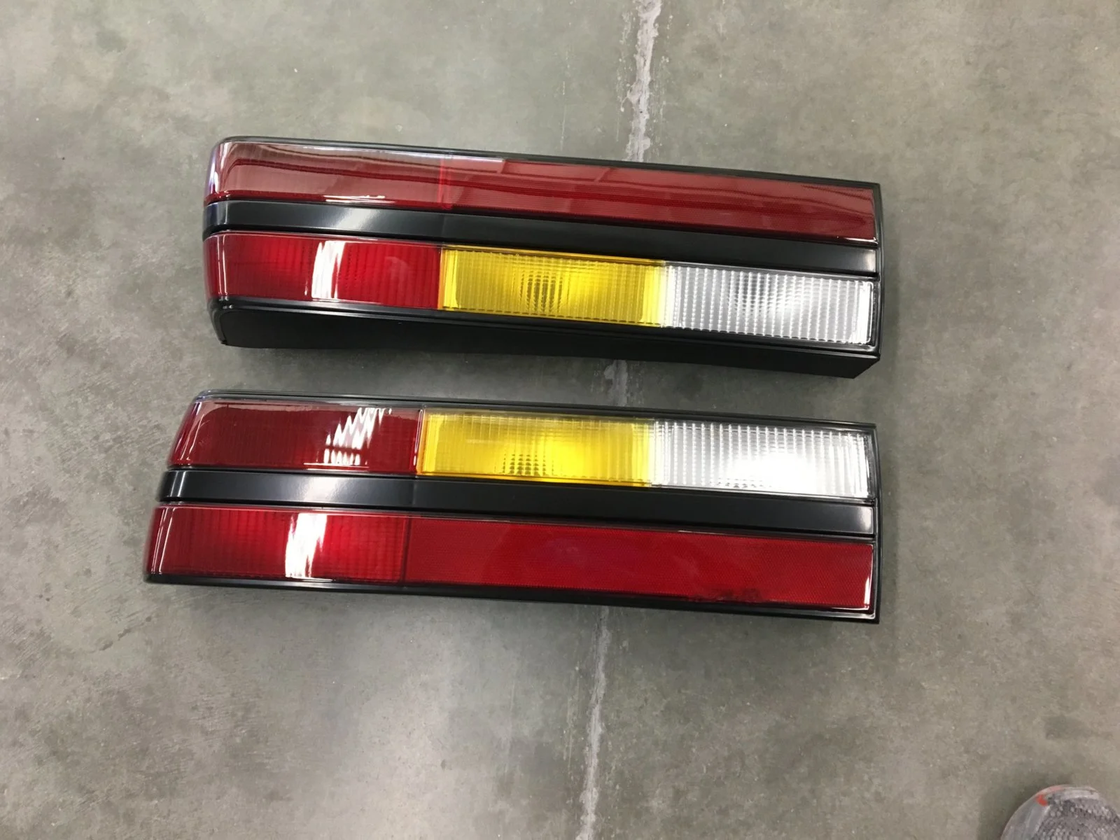

Here’s a gratuitous picture of when I finished them,

Ha that was me about the housing and yes I could probably just spray the new housings. The clips I was talking about are the ones in blue circles. One of mine is completely broken but the others don’t look bad but for whatever reason the lens doesn’t stay snug in there any more, like the little prong on the clip with the teeth just aren’t biting down. The housing is fine though other wise for being original it’s my lens, they have some cracks. I think the LX lenses are the cleanest looking but I also like the cobra lenses as well. Any who it looks as though those clips can just pull off or be replaced. Not sure where to find them.
