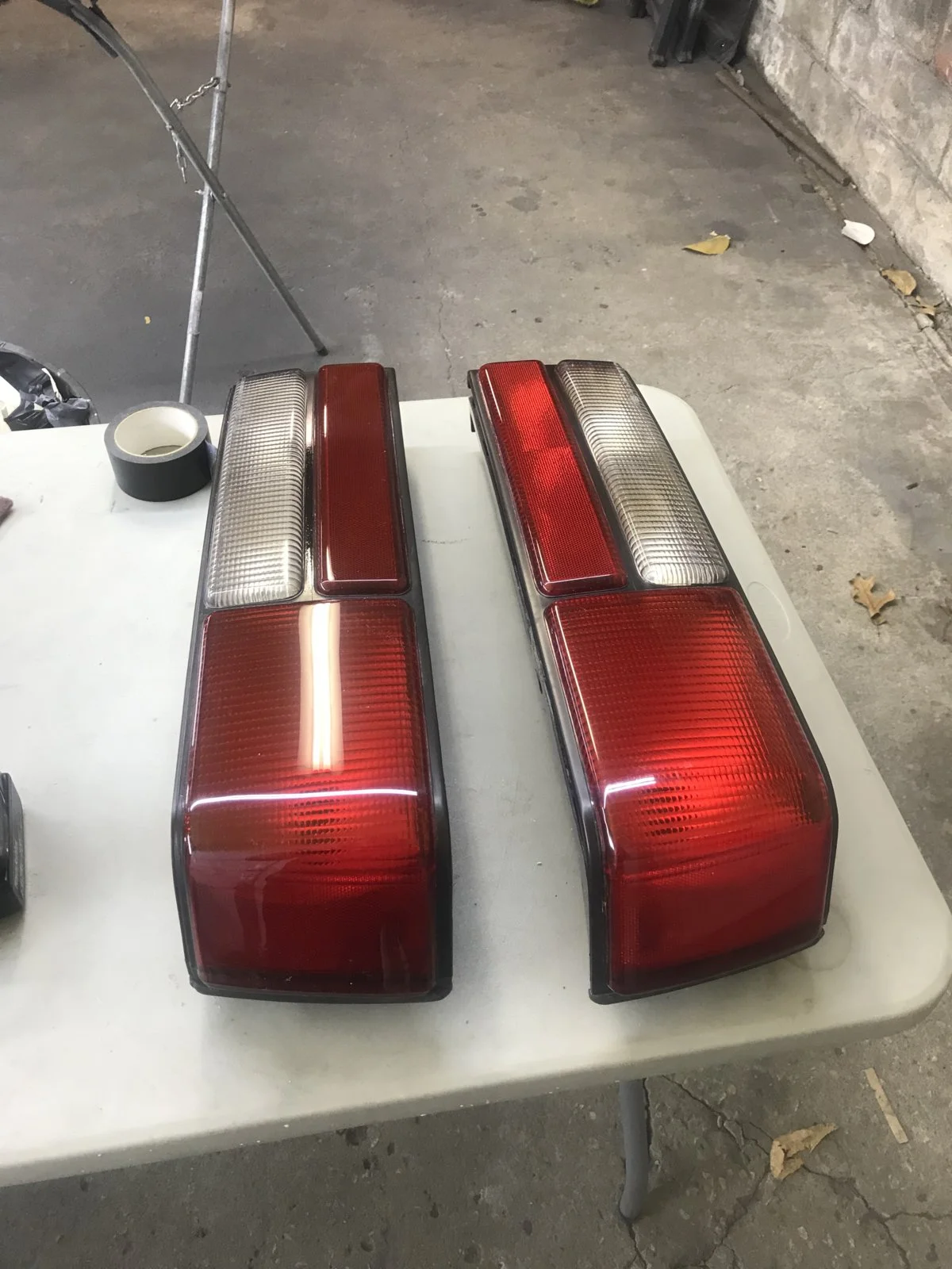

Here’s a gratuitous picture of when I finished them,
Here’s the link to my cliff notes thread.
https://www.stangnet.com/mustang-forums/threads/83-t-top-coupe-cliff-notes-edition.900362/page-11
How are these so glossy?!?!!!!! Very nice

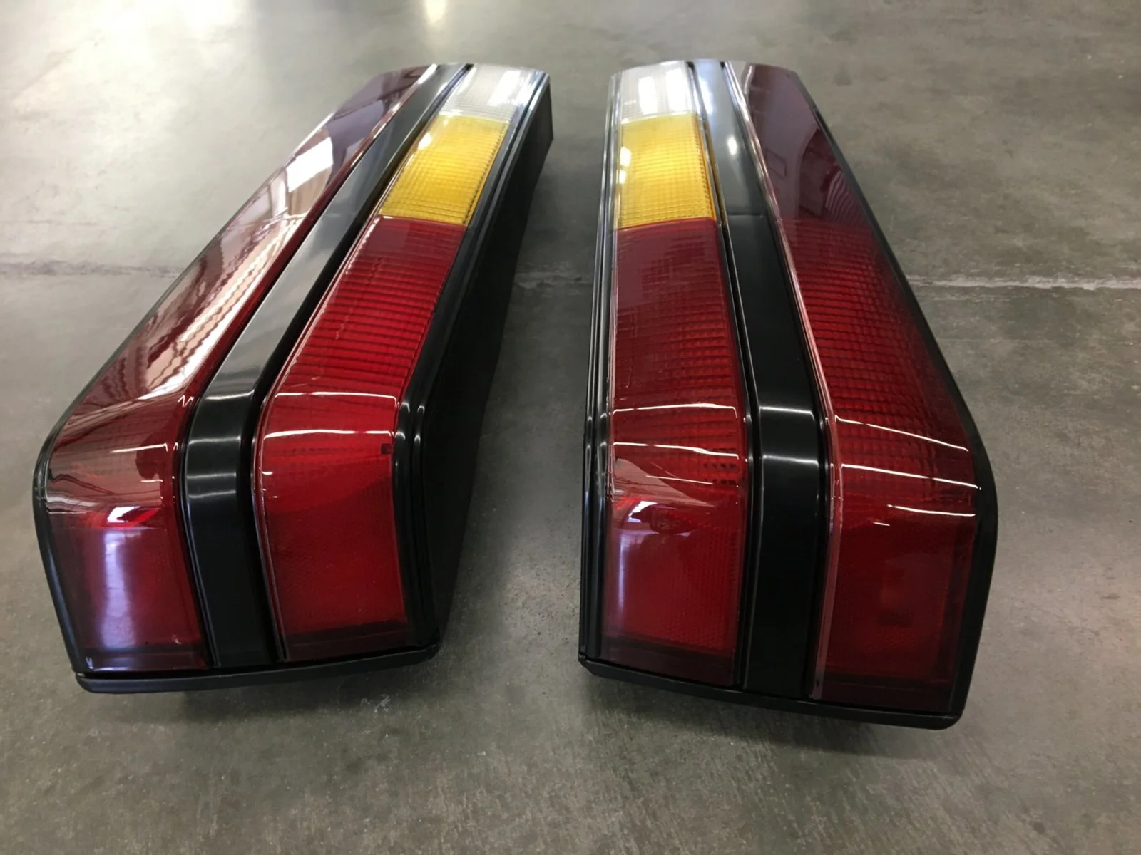

Don’t over look the 83-84 tails. They look like cobras but dont have the small lines running through them. I think those look the nicest. That’s what I put on mine. Dave has the same ones.

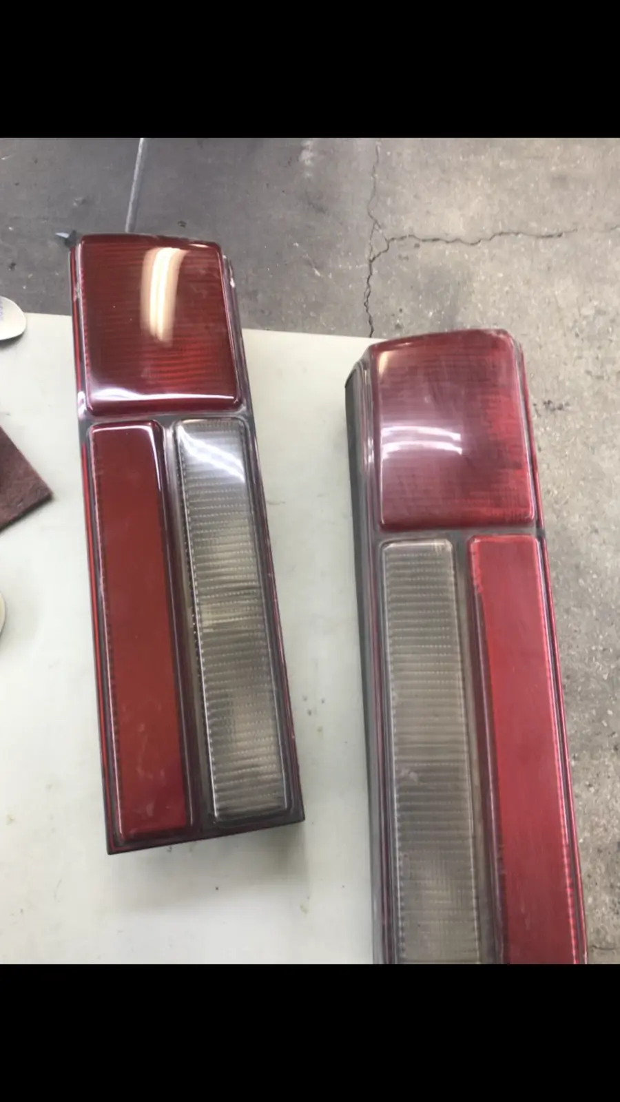

Was pretty easy. Decided to skip clear for now. Mostly I used a old headlight restore kit I had laying around. Used 3000 grit wet and dropped a little lower for some deep scratches. Then polished with meg’s 105/205. Used trim black on the housing and for the black on the lense. Tossed silver inside the housing as well.
