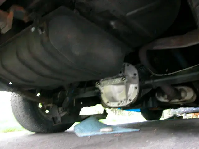

Hi!,about the 8.8 rear,it`s not that bad,if you want to do a fast job,just swap the spring perch from the 8 inch to the 8.8...the axle tube is actually 3inch compared to 2.5 for the II (talking about a 74 rear) it must be the same for all the years,just enlarge it and weld them in place with the correct pinion angle.as far as the u bolt,you`ll need longer 3 inch ones and i wouldn`t re-use old ones anyway...the width is different,it`s an inch wider and it just corrects the ugly gap of the II .The wheels originaly are way too set back in the wheel opening... add some custom weld racing of just fox wheels and your all set! 5 bolt 4 bolt ...it`s up to you,posi units in 8 inch units are $$$ and not that many gears choices.The 8.8 is centered differently than the II diff and if you hear that it will give you bad vibrations,it`s bull sh%$/ Mine runs great with it, use a fox driveshaft with spicer joints and get your shaft balanced by a pro don`t assume it`s ok.I got a new unit from Jeg`s ,the ford motorsport alu drive shaft for the fox.Emergency cable fits right in ,you just need to relocate the bracket of the cable.And finally use a fox flexible line from the car to the diff.....That`s it! It seems like a lot of trouble but it`s actually very easy to do. :D
