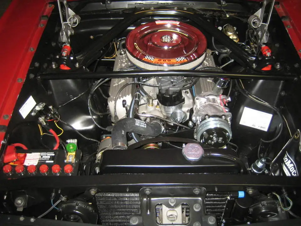

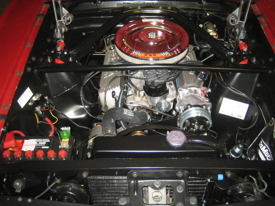

I am the CPR customer that decided to go with an M&R 331 stroker with Procomp aluminum heads. The engine was rated as 380 HP 380 TQ. I also found them through EBay, but I purchased only the long block directly from M&R Engines located in Glendale, California. I paid $3,539.78 with a flywheel and delivery to CPR who professionally installed the engine. Many of the initial pictures are here 331 stroker in a 66 fastback (shelby style engine bay) under cprstreetmachines’ Forum and Current Projects section.
I wanted a nostalgic engine bay that was representative of American muscle. Therefore, I attempted to dress up the engine with Shelby parts with exceptions for performance or reliability. Therefore, during the install CPR and I discussed adding:

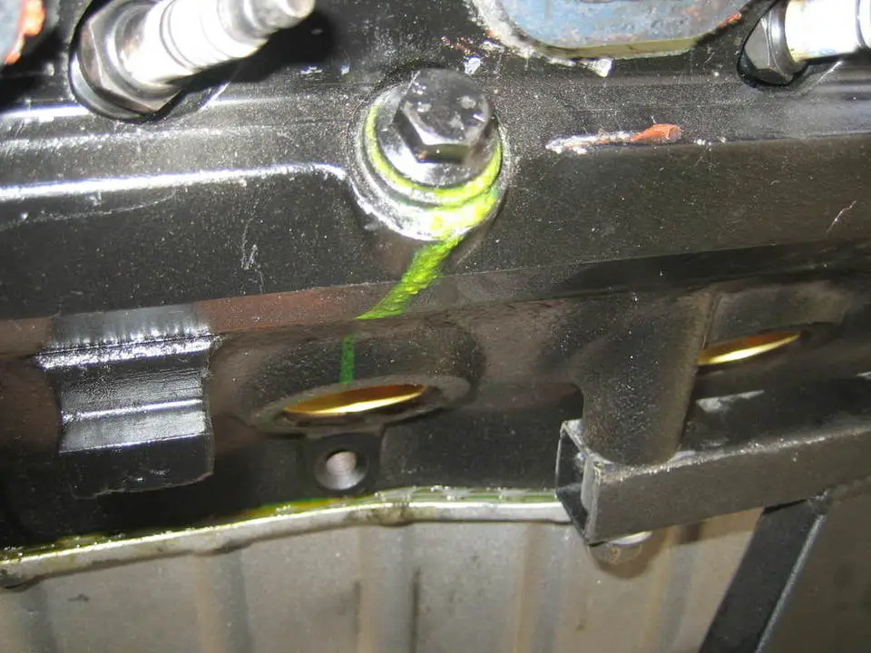

3. coolant leaking from all head bolts.

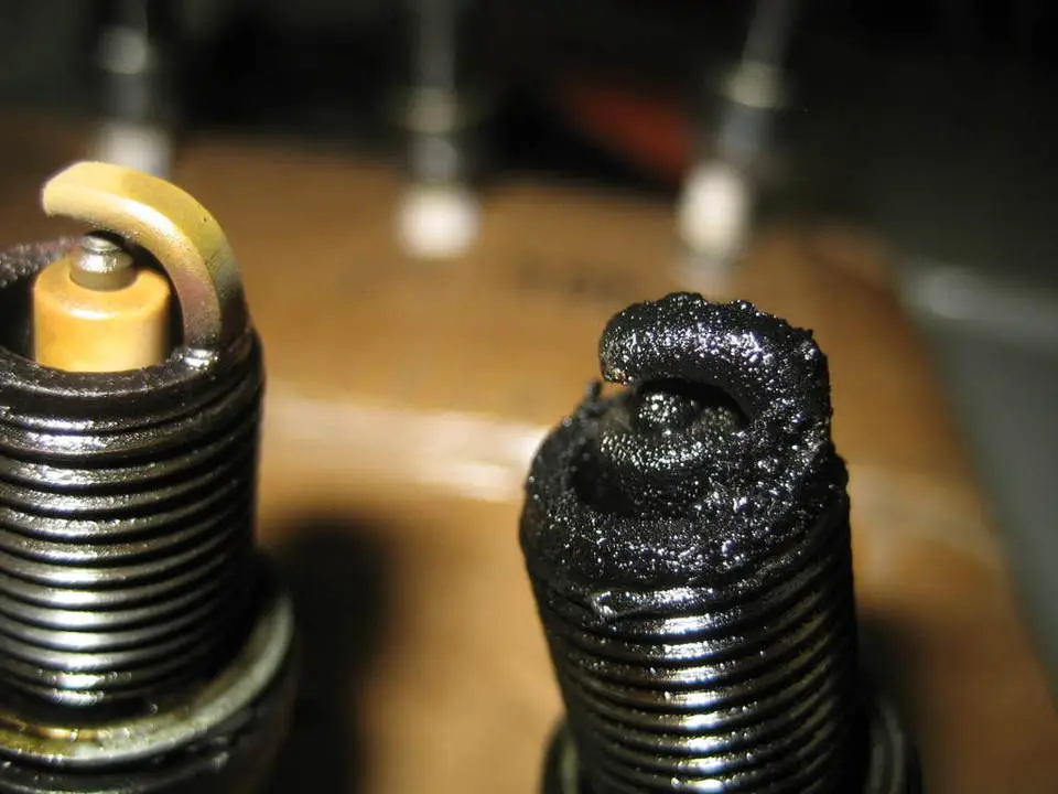

2. Number 8 plug was full of oil.

4. Head bolts continued to leak coolant.

Fouled plug re-installed in number 3 piston, not replaced

At this time, I am unable to tell how the returned motor works. Since, I had to remove the M&R engine I decided to paint and detail the engine bay. I decided to go with a T-5z transmission, 3.80 Currie 8” with traction loc, factory A/C from Classic Auto Air, and a JMC hydraulic clutch kit. My project is waiting for the A/C kit and the hydraulic clutch kit--which I cannot locate (everyone is out of stock). Once everything is running I will report back.

Sorry to be a Chevy guy in Ford forum, but this hobby is too expensive to not share information. My experience with these guys was poor also. Bought a long block. Pumped 2 or 3 quarts of antifreeze into the pan in the first ten minutes of run time. When they clearanced the block for the stroker, they ground into the water jacket.

The engine was re-installed. With the engine install I upgraded to a T5, Cobra clutch, A/C, limited slip 3.80 from Currie, custom driveshaft, and hydraulic clutch kit. A few other engine bay touches to make it look pretty.
