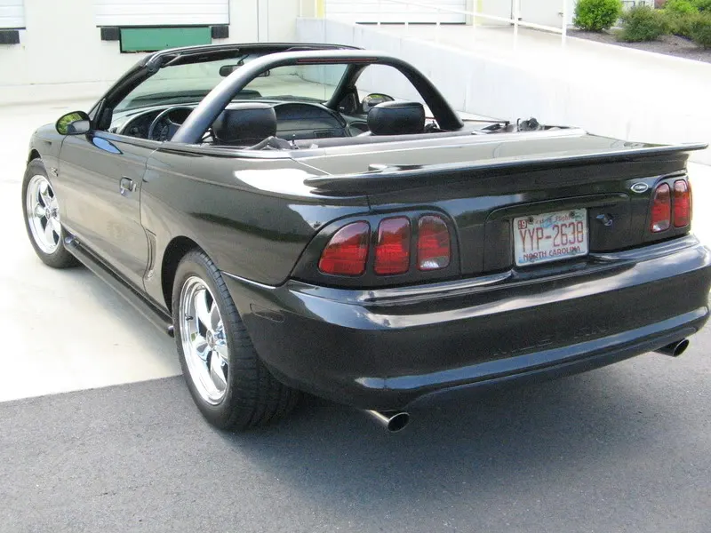

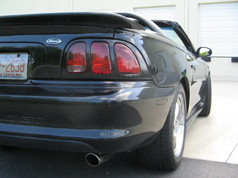

I installed a MAC o/r H pipe and cat back on my 1995 gt and i cannot figure out why the tailpipes do not extend out past the end of the rear bumper. For that matter it seems as though they hug real tight to the gas tank. Any ideas why this thing fits this s**t ?? :nonono:

ok for those who were asking what h pipe and cat back i bought..... I have the o/r H pipe for the 94-95 mustang v8 seeing that my car is a 5.0... and it already had MAC headers when I bought it so everything bolted up great. I then purchased the cat back system pn# TK7995 from www.bieberfever.com due to CJPony parts telling me MAC didnt make this kit anymore which is complete BS. anyway it is 2.5" with 3" chrome tails designed for the 87 to 95 GTs. I took the car to the exhaust shop on friday and its in there but it rattles off something really bad and they said it is a really tight fit.... Sooooooooo i may have them make me a custom cat back set-up..... any thoughts? thanks
