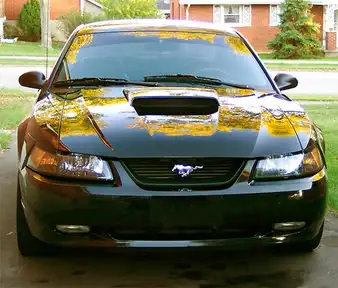

The final result really cleans up the look of the car.
:nice: :nice: I love how it gives the car a more aggressive look.:nice: :nice:
Best of all my wife likes it and there will be peace in the Blue household. (for a few days anyway)
This kit came to less than 40 bux. I like it fine. I could have bought the 3 pc kit i kinda like that you can see all the way. It reminds me of blacked out grill on my '68. As for :owned: the kit was inexpensive and looks good on the car and most of all I'm happy. Can't be :owned: for that.:nice:
