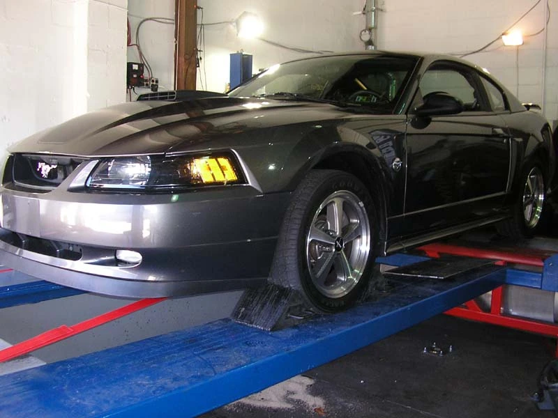

Is the Mach 1 car flush with the fenders, or the front bumper?

The fenders more or less, its not really that noticeable.

I just went out and checked, its perfectly flush with the fenders, maybe 1/4" from flush at the front.

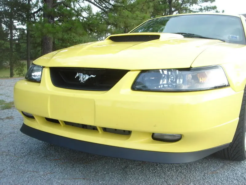

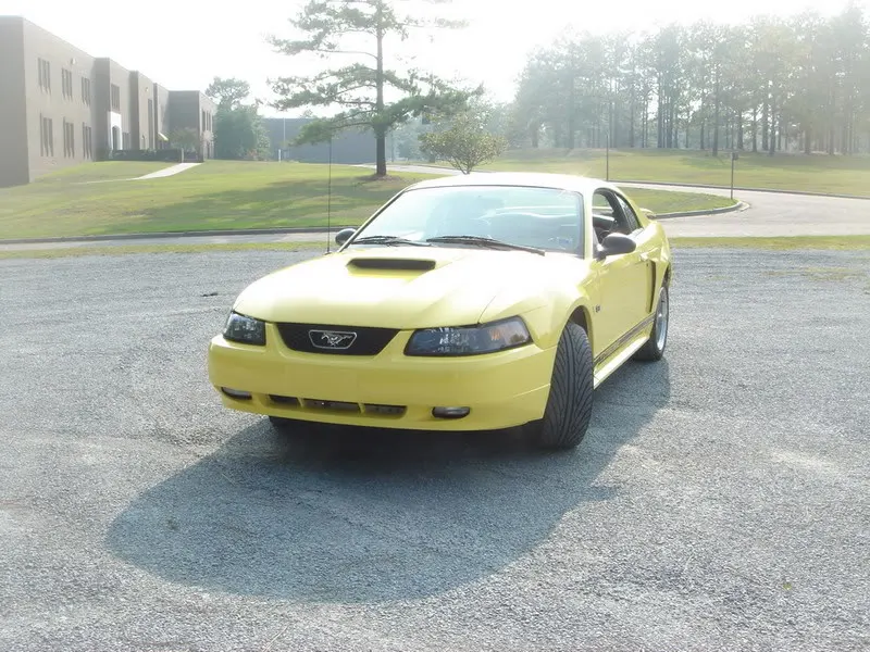

just had mine installed last week as well, and with you having the same color car as mine, going from this:
to this:
makes a world of difference. mine didn't sit flush with both sides, but i didn't mind, throwing on the grill delete adds a lot to it as well. i also had the benefit of my friends shop with a lift.
edit: you can see in that pic where it doesn't align with the edge.
