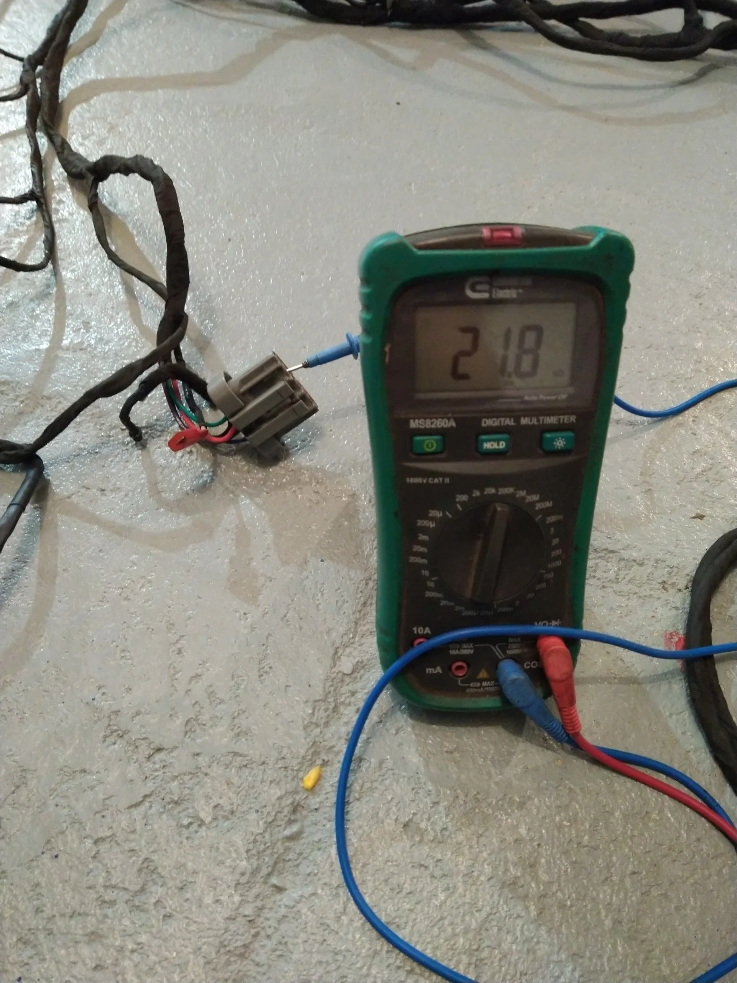

If the car got that far out of whack twisting the distributor with the Spout plugged in and is a 5 speed Id say to check to see the resistance between pin #4 on the ECU plug to pin #2 on the TFI module plug....
You should see 22kohms of resistance with meter set to 200k .............
If you see a 0.00kohms you need to either add a resistor or replace the one thats shorted to "OPEN"
The other possibility is that your ground wire to the engine block to the frame needs to be stronger and you may need to clean the 2 dedicated ECU ground wires that are behind the battery attached to the unibody stacked up on top of each other.........
