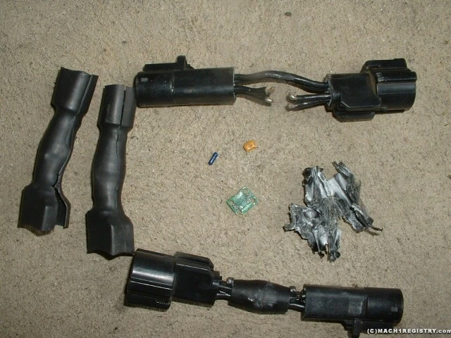

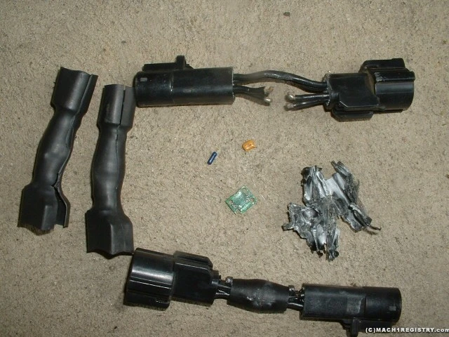

First attempt bombed:

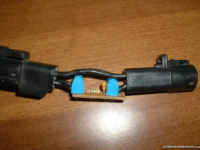

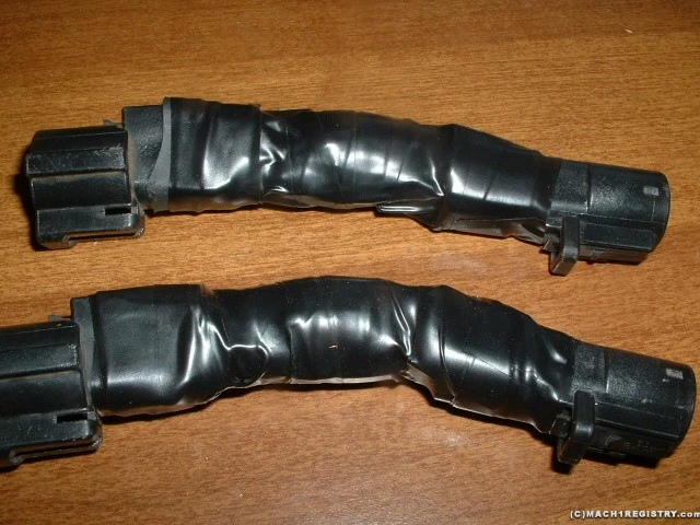

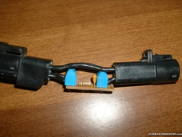

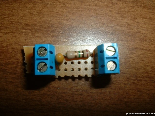

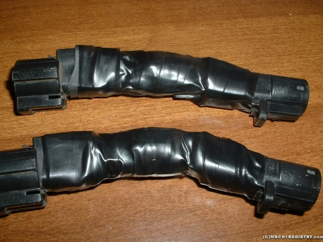

Made myself some MIL eliminators

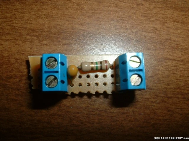

This time I took my time and used a pcb board!

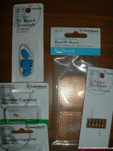

Compnents are:
pcb board
1/2 watt 1 mega ohm resistor
1 microfarad capacitor
quick connects
gutted non-working mils
They've been working for over a week now.
I'll be sure to post if they quit working.
componets:
