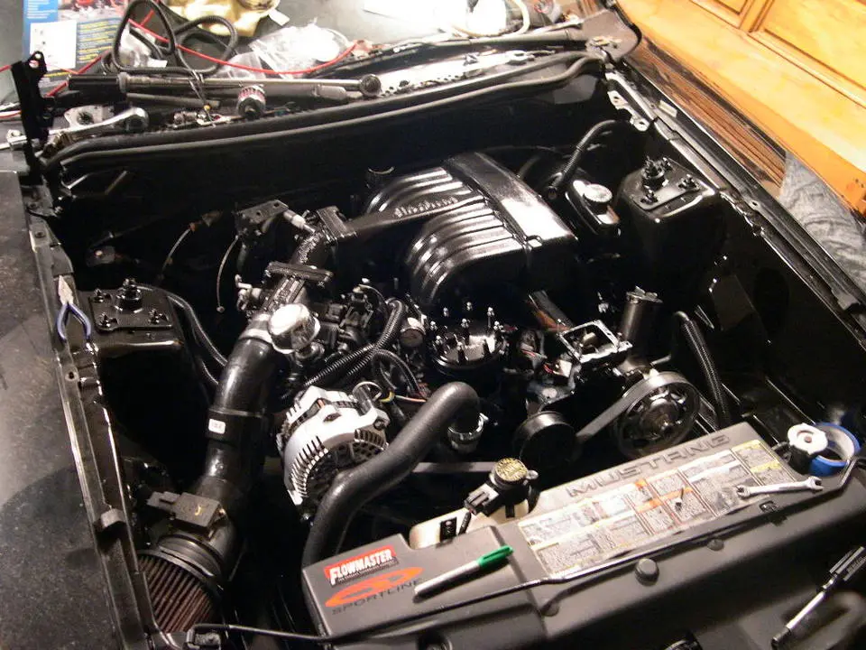

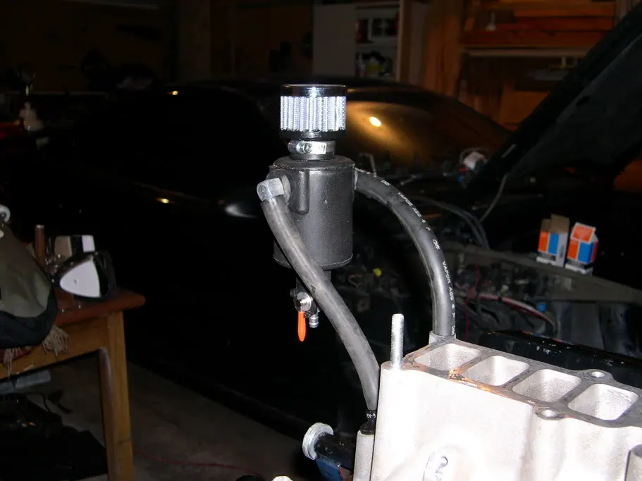

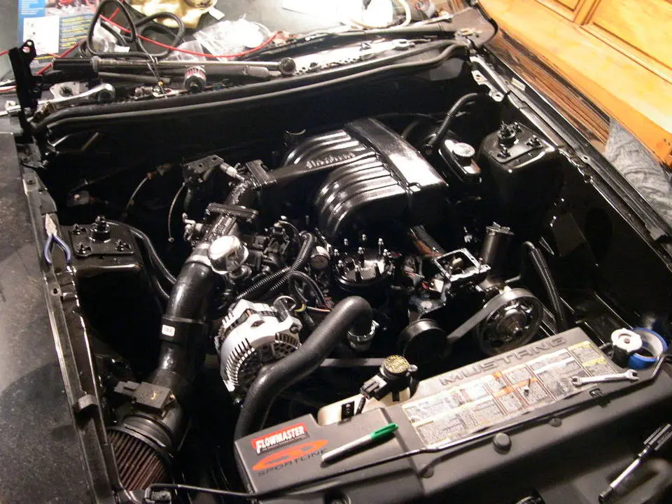

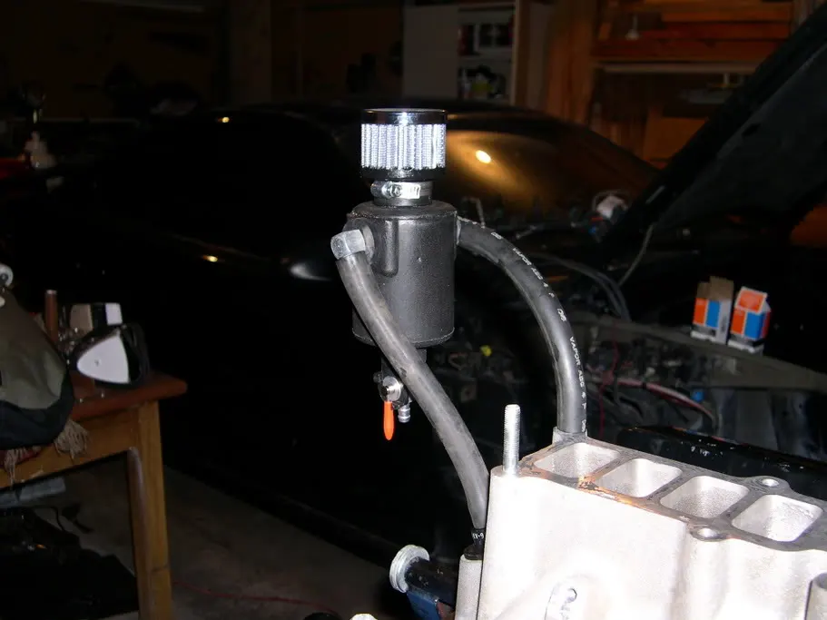

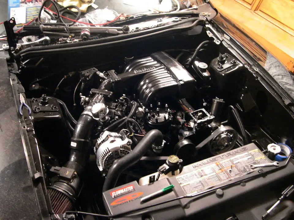

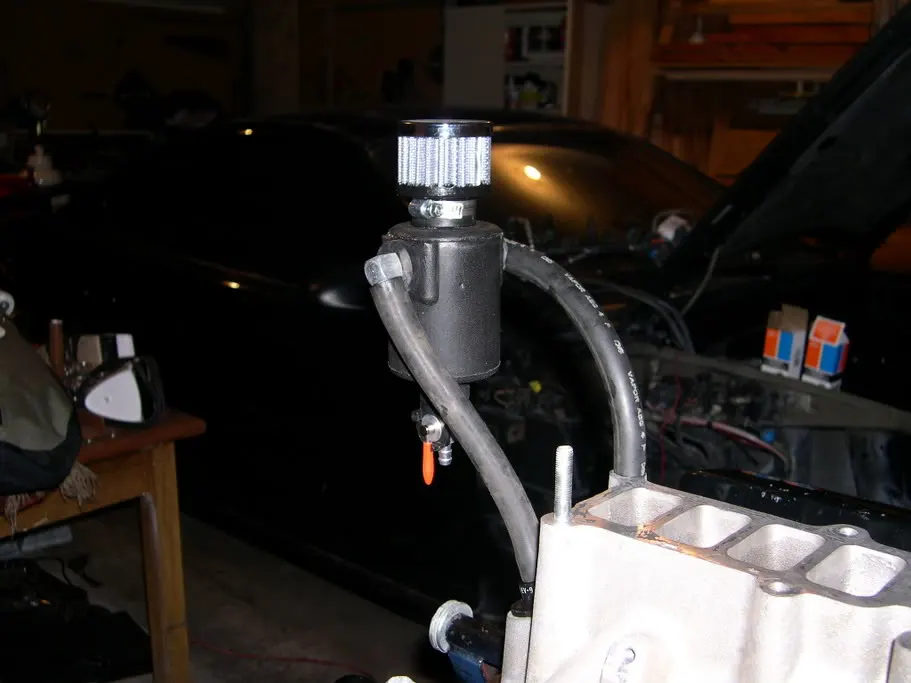

Jaz Can. I bought it awhile back. I think it was like $45.
And you can see if peepin in this pic
Jeremy

That looks great, :nice: my question is what happens when it fills up with oil? How do you even know when it fills up with oil? Most oil traps on compressors I have seen where clear, I know that my pcv lets tons of oil past and I think it would fill up rather quick. It has a drain on the bottom, but where would you route that to?
I think NO RICE was asking about the Jaz can and knowing when it was full.
One could run a drain back to the crankcase, but who would want to do that? Blah. One could install a sight glass near the top or just play it by ear. I dont have one of those so I bet Jeremy or one of the other guys might have some insight about what they do.

The can roughly does the same thing as the separator, and the same principle (in terms of knocking down oil-laden air) applies to open and closed systems (breathers, as Jeremy has, and closed PCV systems, respectively).
I bought my can because my old motor had a lot of blowby. It was intended to catch a lot of the oil that was getting sucked up and coating the intakes and valves. But now that I have a new shortblock with only 700 miles on it, it won't be that neccessary. Sure it can be looked at as not the best because its not clear and you can't see when its full. But its also not that hard to just turn the valve and drain it after a day of driving. Jaz does offer it in a white can so you can see the level but as you can look at my engine. I prefer black.
Jeremy
