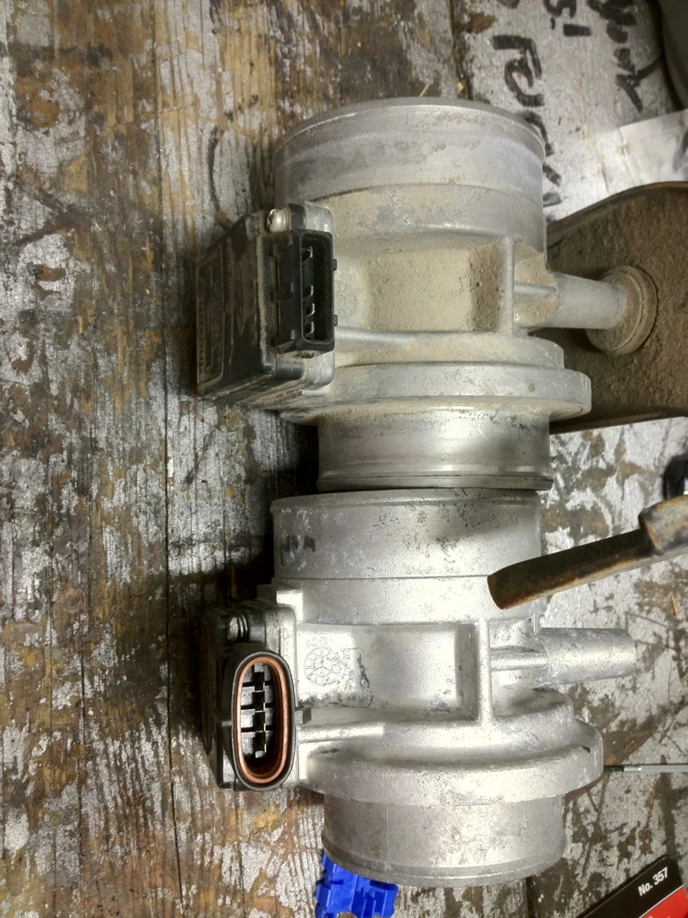

Pulled MAF off of a 88 gt, I believe it was a Cali car.
What is the difference in the plugins on these MAFs. One on the top is the one off of the 88, the bottom is came extra with my buddies car, which also has the bottom plugin on the harness.
What is the difference?

The MAF body and sensor are designed to match each other. Therefore you can't swap sensors between different part number MAF bodies and maintain proper calibration. The assembly is designed to match the computer’s internal program, and swapping a different MAF can upset the computer's calibration. In other words, your monster MAF probably won't match the calibration of your 5.0 Mustang computer.
The OEM Ford MAFs are not calibrated to injector size. The injector sizing is done in the computer’s internal programming. Aftermarket MAF’s “lie” to the computer in an attempt to fool the computer into changing the injector pulse on timing to match the increased airflow.
The only other MAF that is a one for one swap for a 93 and earlier 5.0 Mustang is the 94-95 Mustang MAF.
94-95 Mustang GT MAF - $40-$100. It is 70 MM instead of the stock 55 MM on regular stangs built prior to 94. It uses a slip on duct on the side that goes to the throttle body and a 4 bolt flange on the other. You need a flange adapter to fit the stock slip on air ducting that goes to the air box. Wiring plugs right in with no changes. *1 *2
Once your replacement 70MM MAF is in place, disconnect the battery for about 10 minutes. When you reconnect the battery and start the engine, the computer will relearn the settings for the new MAF.
