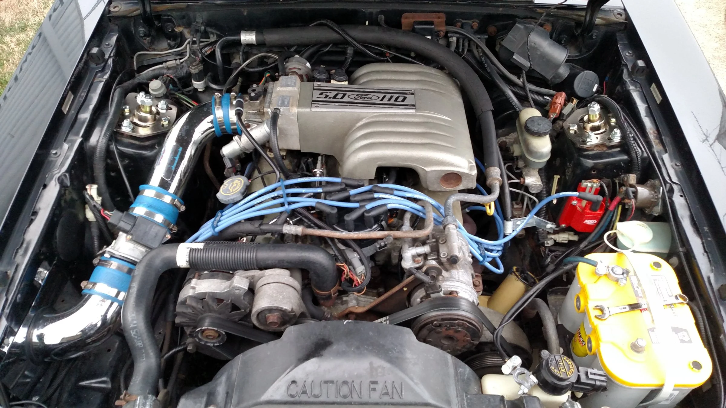

I have a very similar setup, minus the manifold, and i went with the SN95 MAF. Felt a little snappier on the bottom. Ebay adapter worked fine. Google it, theres a ton of info on what car you can grab the MAF from, it's not just v8 mustangs
Does the CAI have to modified if I use the adapter and sn95 MAF?
mattyv
Well-Known Member
Feb 1, 2016
137
103
63
New York
Jun 20, 2016
  • Jun 20, 2016
No it doesn't. Here it is installed, you can see the black adapter on the air filter side.

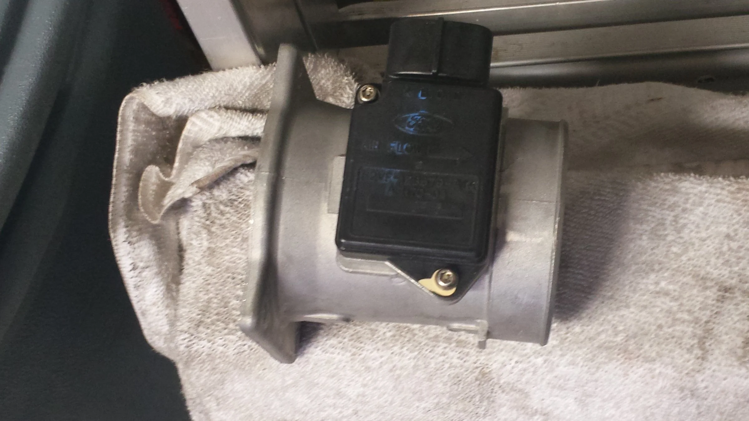

This- 94-95 GT 70MM MAF and the adapter.
