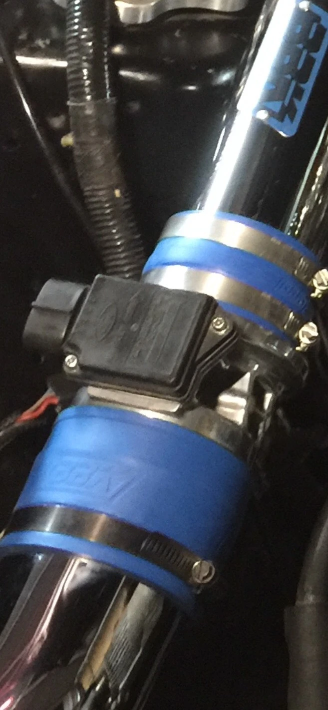

Well it runs like crap when its cold fuel injected im assuming it shouldn't do that and it idles at 650 when I go home today I will take a picture of the MAF. Now one thing im assuming they are the 30lbs because of the color being orange on the injectors.

MAF

looks like a stock maf to me. Run the engine codes
